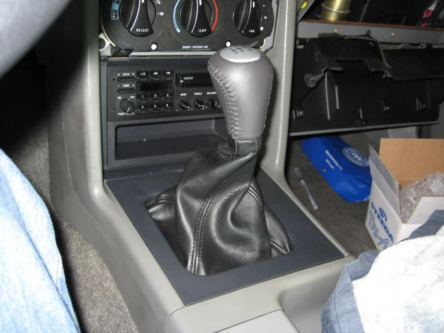

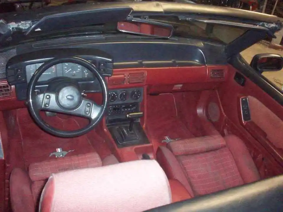

WANTED: Pics of interiors with Stock Fox radios.

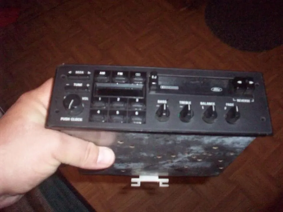

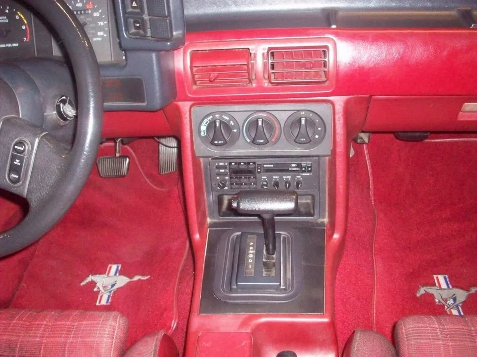

my 92 coupe still retains its original premium sound cassette deck with EQ......AND IT ALL WORKS!!! have no intention whatsoever of removing it. it has one light burnt out on one of the slides for the EQ that i would actually like to have fixed. i use a small $13.00 fm modulator for my ipod tucked away in the glove box. works perfectly. no wires...no clutter...and no ones desire to pop out a door lock or window to relieve me of an aftermarket stereo! besides no one really wants to hear my Motley Crew blasting anyway. YEA i said it,,, Motley Crew! LMAO!
