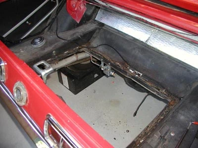

It's a Holley Red Pump and it is mounted lower than the fuel tank on steel straps just about 2 inches of fuel line from the feed on the tank. I could not get any closer.
you may want to slap a pressure gauge on there to see what its putting out.
It says it has an external pressure adjustment.
My carb guru talked me down from 7lbs to 6 to 6.5. He said when theres a quick slosh in the fuel bowls, (while cornering, quick stop, offramp) and the float moves, too much gas comes in too fast, causing a stumble or cut out of the engine.
Also my brother had a Holley red act weird on him, he had it exchanged for a good one.

I noticed from later post that you stated you have the pump mounted on some straps. I had an another 65 coupe with an electric pump mounted to the frame near the rear tires and I think I remember that the pump got it's ground source from the body of the pump. Is your ground source clean and firm?
