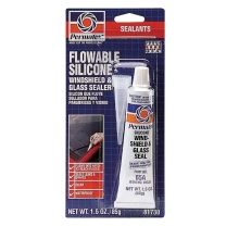

Drain and dry headlight, take them out
Buy this
Permatex Clear Flowable Silicone (Any Auto Store)
Squeeze it onto a Q-tip or your finger tip and spread it around the seal where the clear plastic of the headlight meets the back gray plastic of the headlight
Get a good coat on it and go all the way around.
Let it dry and then re-install headlights
(Did this to mine cause I had same problem when I got new lights and even when I spray the lights from every angle when washing the car water doesnt get in.)
