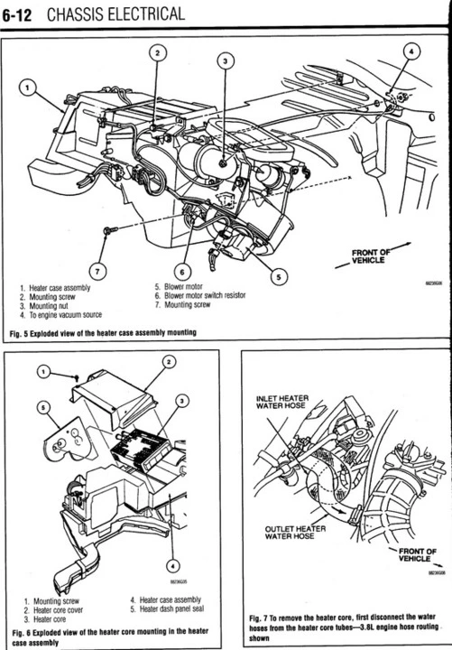

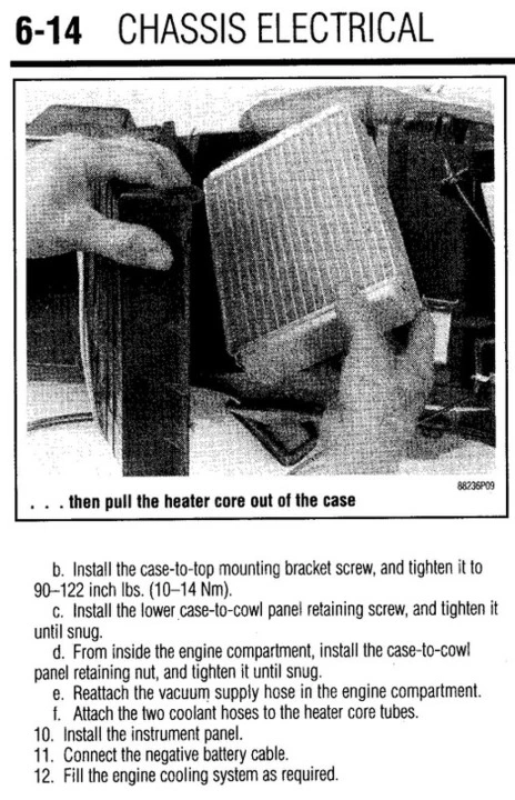

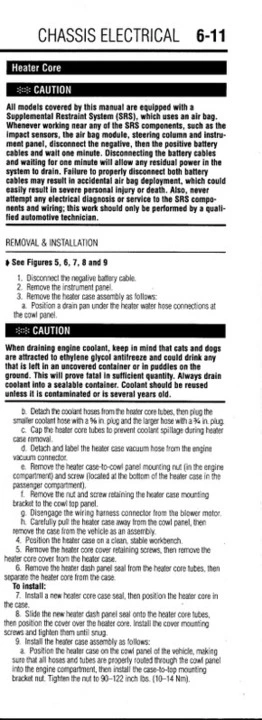

are you loosing coolant and having to add to the reservoir...and i have used a white cloth to dry up carpet and if its colored like coolant its coolant....its an all day job to replace..not the best instructions below but maybe it will help...

I had the same problem and eventually the heater core went out. Its not an easy job thats why I have not fixed it yet. The part is only like 50$ , but its almost as if the whole car is built around it. Dash would have to come out at minimum.
if you were to take it in and have somone else do the labor it would be a hefty sum
