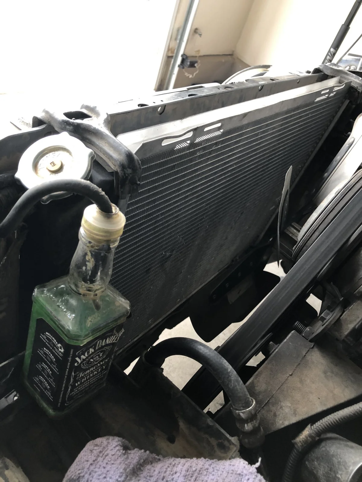

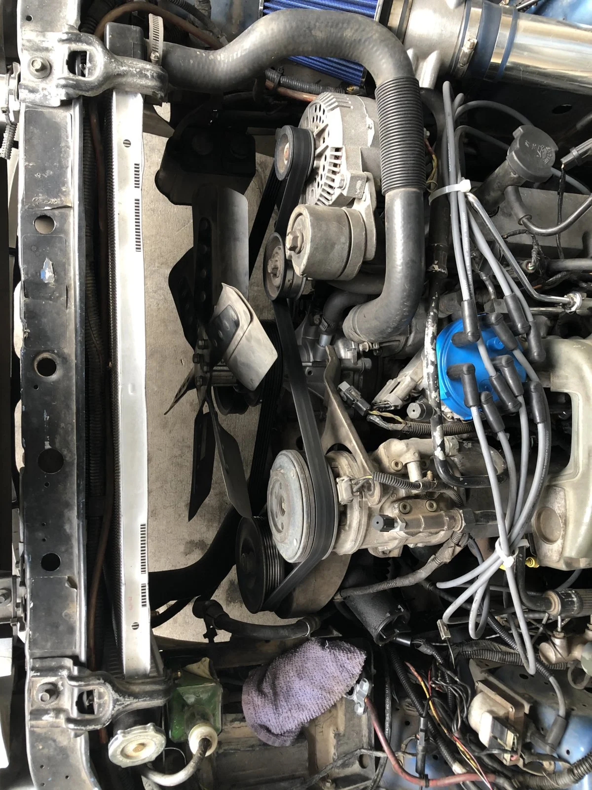

how is your system set up? Maybe some pics?

My overflow bottle is a jack Daniels bottle that sits on my battery tray.
I hope the cap solves your issue.on another note or two a fan shroud will be a good idea,also the stock overflow tank and move the air filter out of the hot engine bay.Good luck and keep on rocking baby got to keep on foxin.
