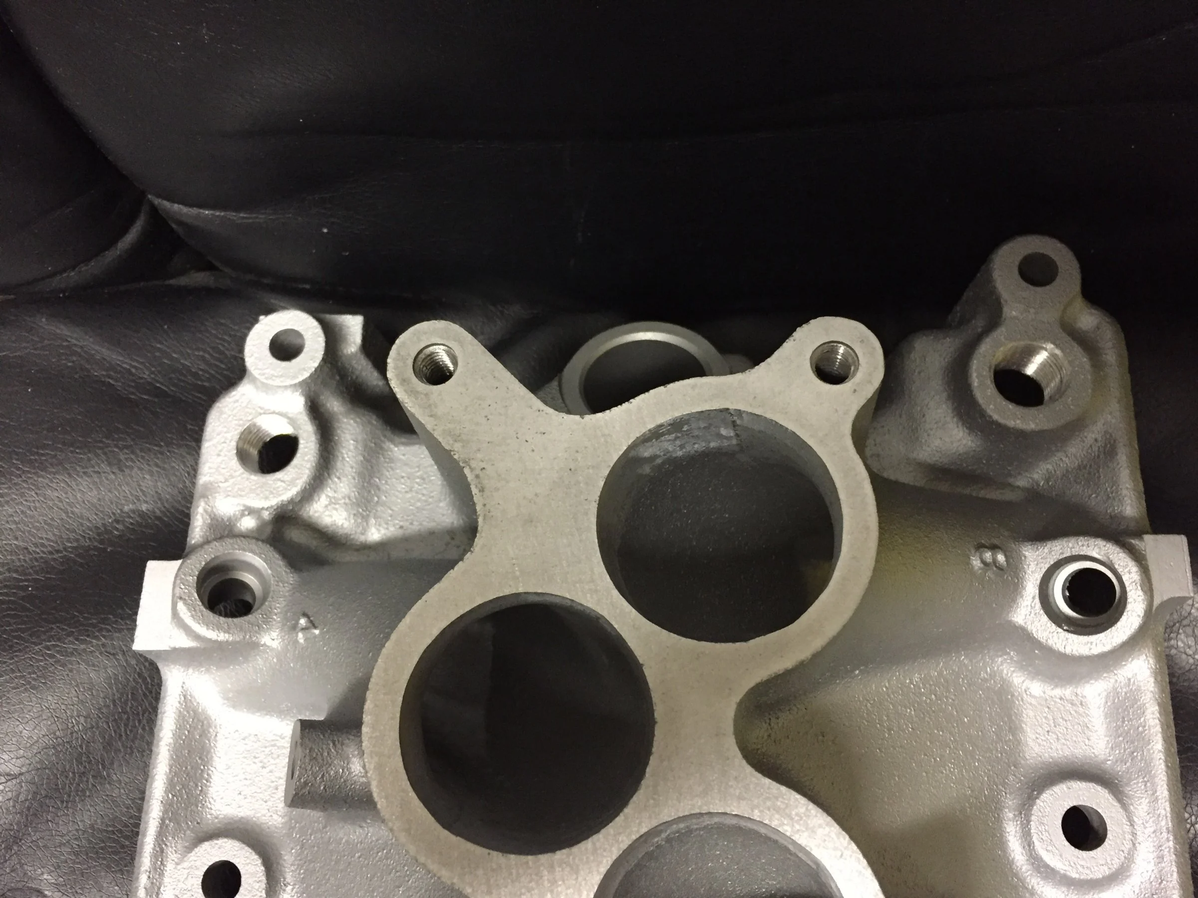

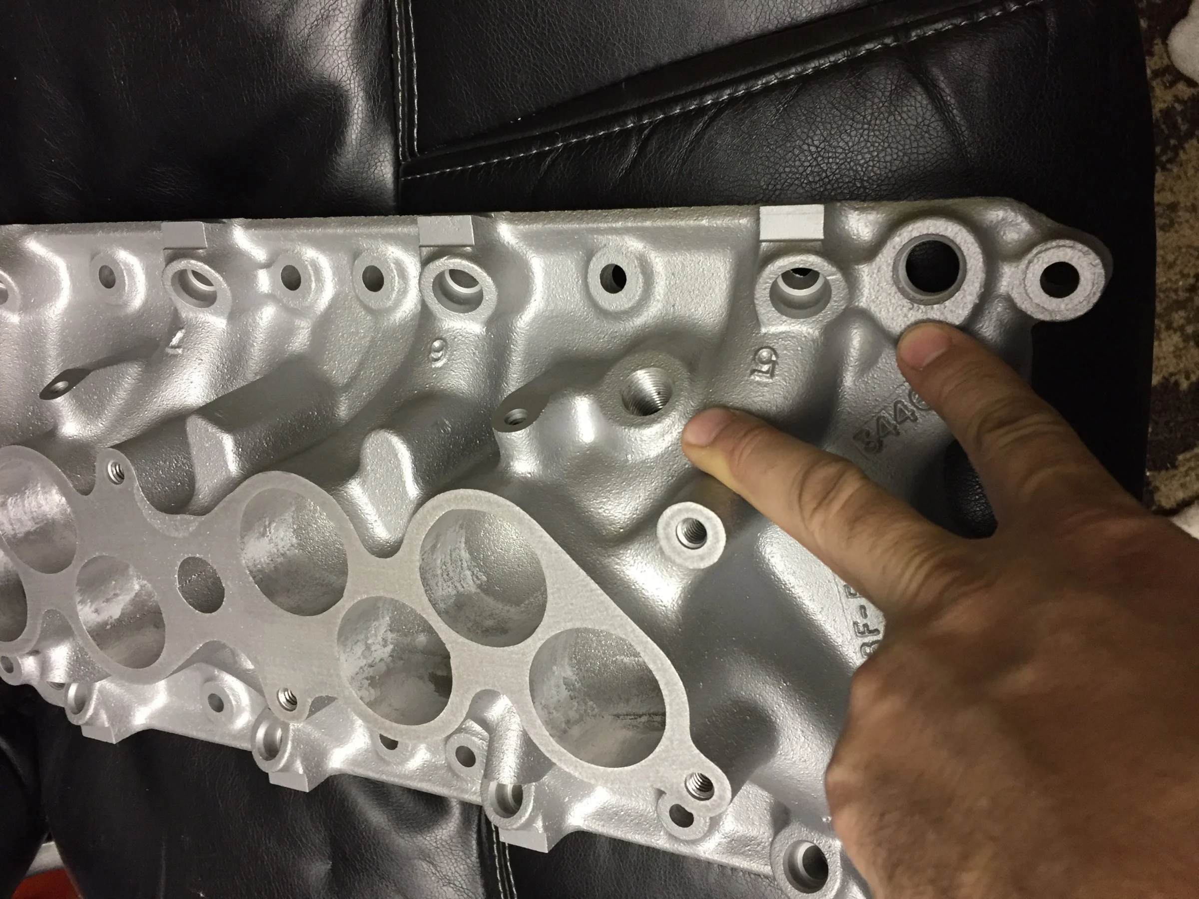

3/8" npt
There's a plug in the lower intake manifold at the drivers side rear. This can be removed and the temp sensor wiring extended to reach. That's if you don't want a dead stock guage in the cluster. It will read cooler here however
Than
3/8" npt
Thanks for the reply! So the stock npt size is 3/8? I don’t care about the stock gauge going dead but thanks for the tip man!
Both these locations and two on the rear are 3/8 npt
Reactions: 1989LXFOX

Just don’t overtighen the sender, you’ll crack the lower intake!
