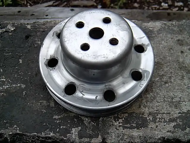

I recently found out that a waterpump pulley is a rare item or sumthin.. autozone, kragen, and pepboys dont carry them..neone no where to get one fast?? another question i had is if neone noes if the 2.3 waterpump pulley is the same.. my engine came without one so i cant match them up..but my 2.3 has two pulley's on the waterpump.. a big one and a smaller one.. Does neone no if one of them is the same as the 5.0's?? thanks
If you want just the "single" water pump pulley, just drill out the four spot welds and break them apart. It's easy.
