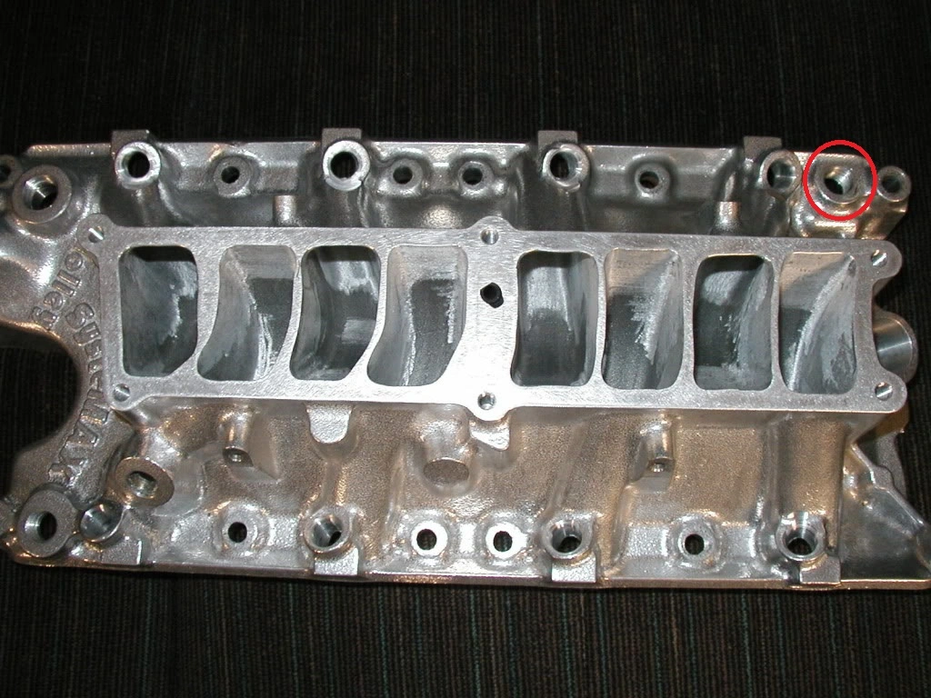

To confirm, the stock gauge sender is in the *front* of the lower intake, driver's side. The rear port doesn't get very good coolant flow and can read erratically.
The gauge has been in the same spot for 5 years without a problem. I did get pulled over when the gauge was reading 160 and I saw that the electric fan was running which only come on at about 195. Now I am 90% sure the gauge is the problem. I just wish I knew what would cause the gauge to suddenly go bad.
All I can answer for is the stock intake (I'm not sure why an aftermarket unit would be different. Maybe someone else can speak to your particular intake).
With regard to the stock intake, there's obviously a coolant port back there, but the issue is that the flow [back there] isn't very good. It's not a bad place to put the stock sender (since the stock gauge is kind of inaccurate), which then allows the stock sender location to be used for the aftermarket sender/cap tube.
