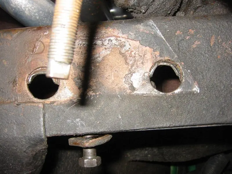

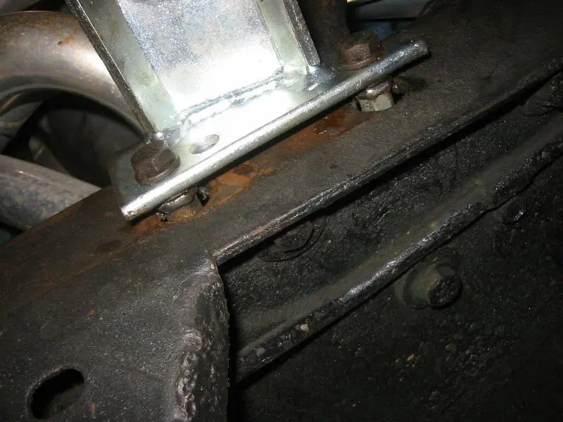

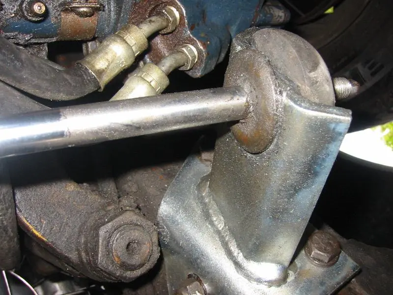

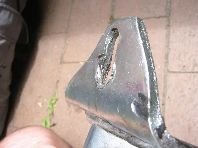

Well I have discovered what the cause of the problem. When the shop put on the drop bracket for the flowtech exhaust one of the bushes was not replaced properly. :nonono:
This resulted in the PS shaft levering against the bracket instead of pivoting, eventually (less than 500 miles) ripping the mounting bolts through the chassis rails, as well as bending and tearing the bracket itself.
Now I am going to have to have the chassis rail fixed before I can drive the car again. :bang: Reminds me why I almost always DIY, because this is what happens when you take it to incompetant shops. :mad:
