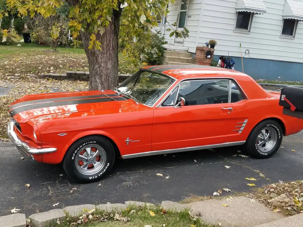

Sorry for the slow response, finally got the motor rebuilt, finished it 2 weeks ago... changed the pistons (few were damaged), rings, lower bearings, oil pump..all the gaskets. And few other minor things. Pictures to follow....thanks for all help...

66 mustang...needs body work and paint now...that's my next project..well, after leaf springs...
