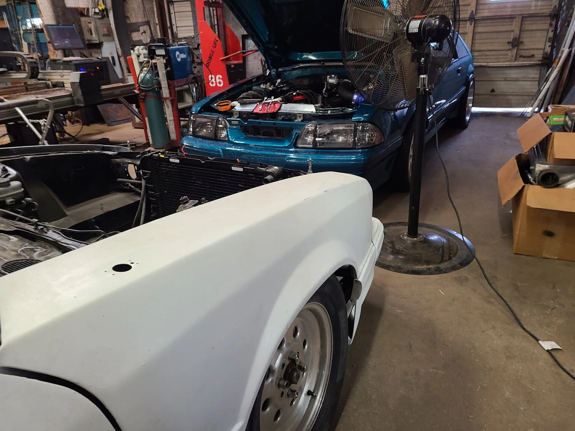

Well, I am now a 2 Foxbody household!!!

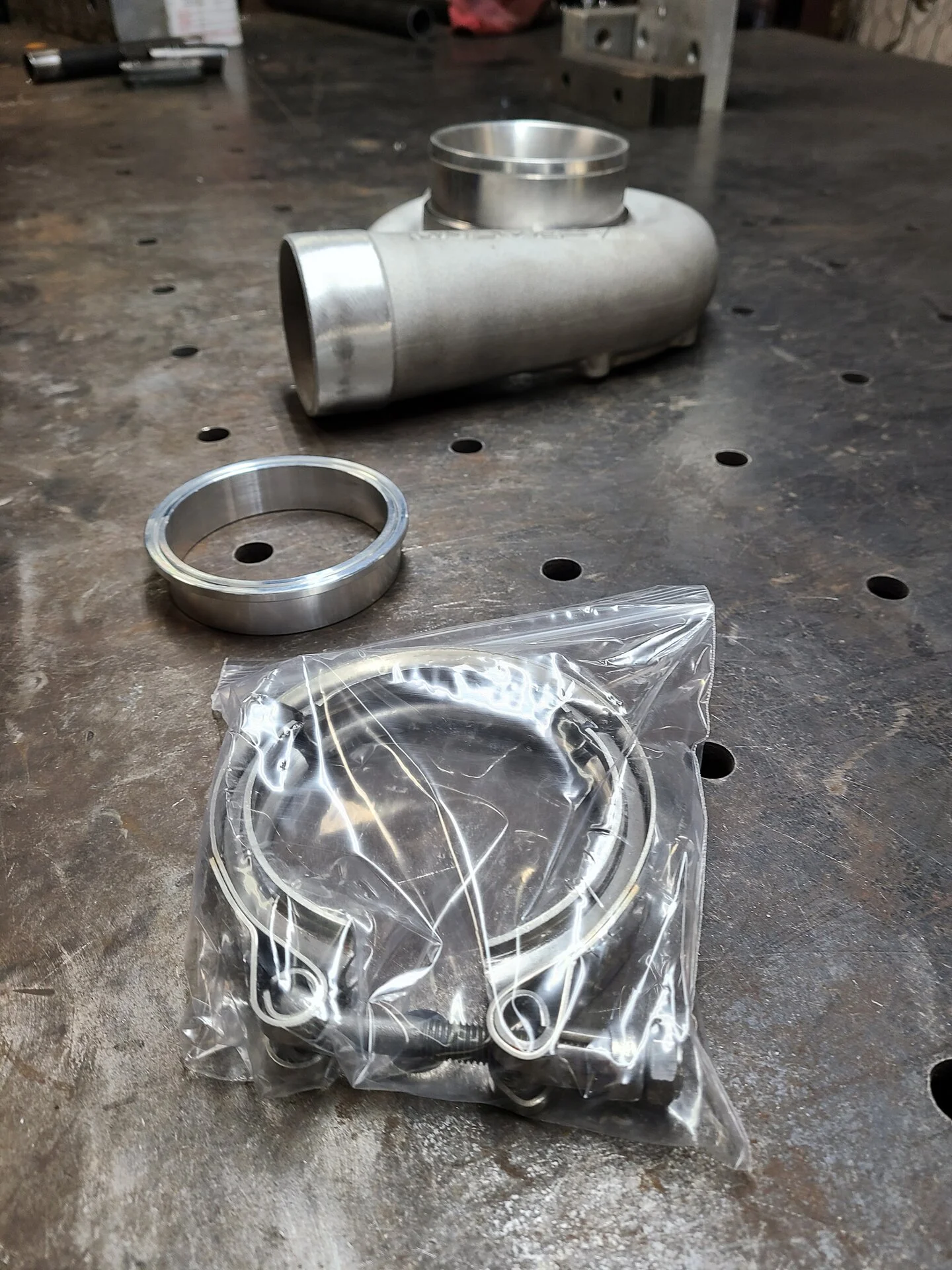

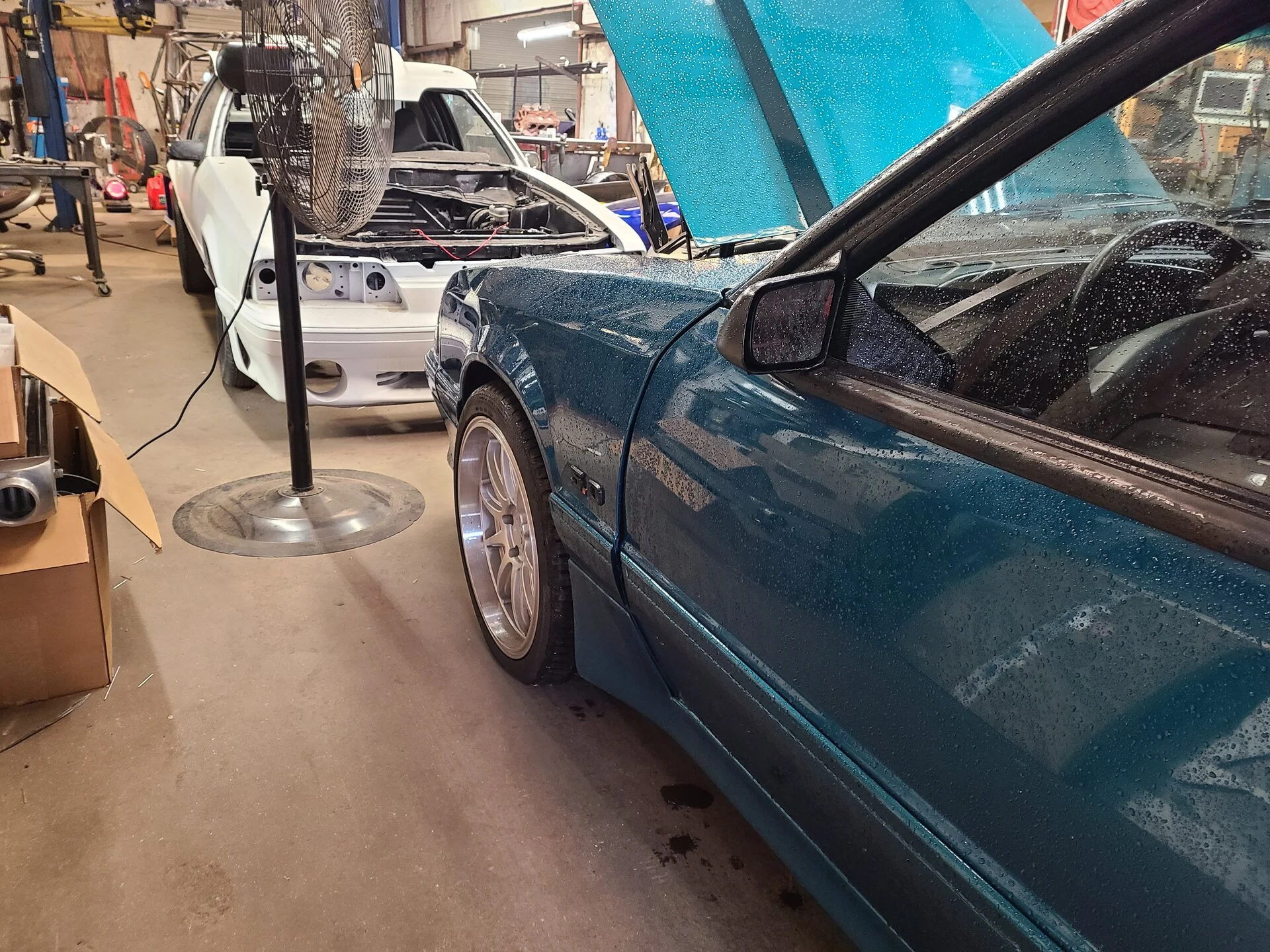

Getting v-band put on charge pipe and turbo. Previous owner had issue with it poppin off bout 6500-7000 rpm. So, fixing that. And for a few hours today, the 2 fox bodies got to hang!!

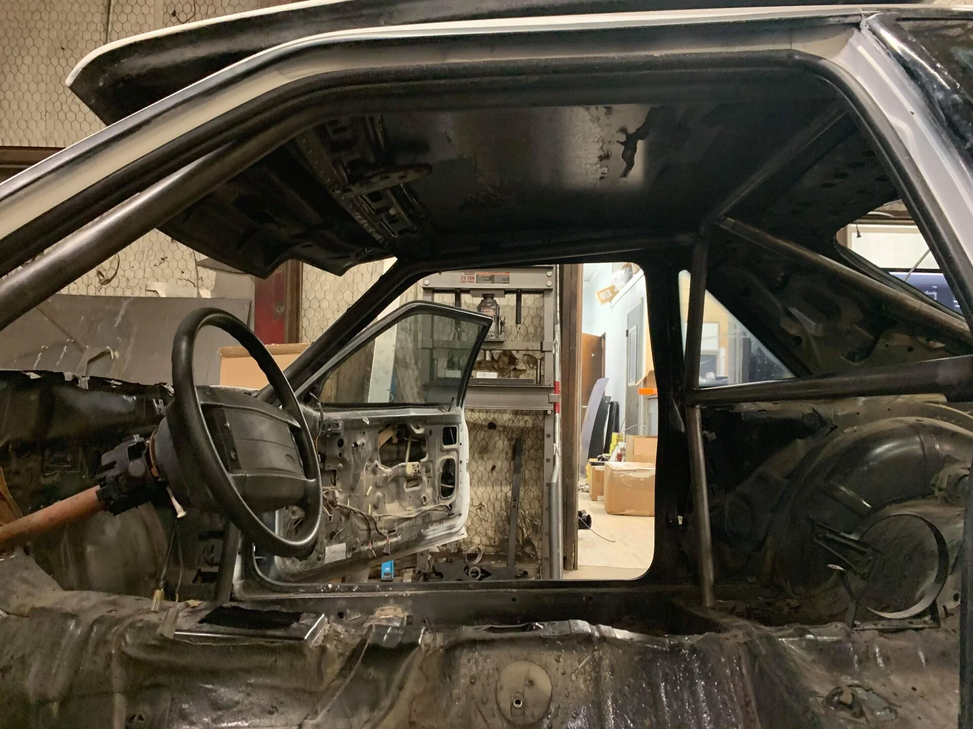

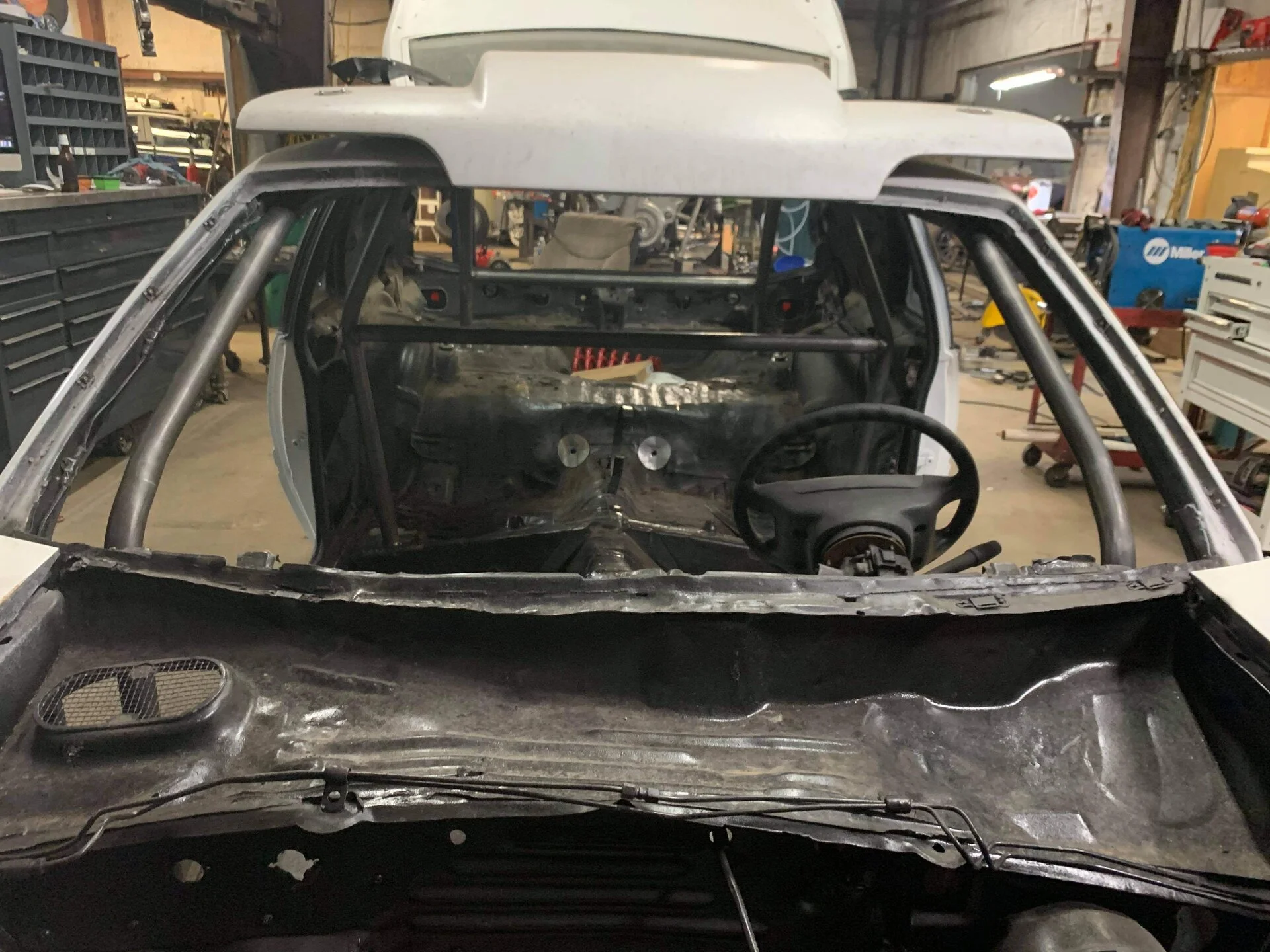

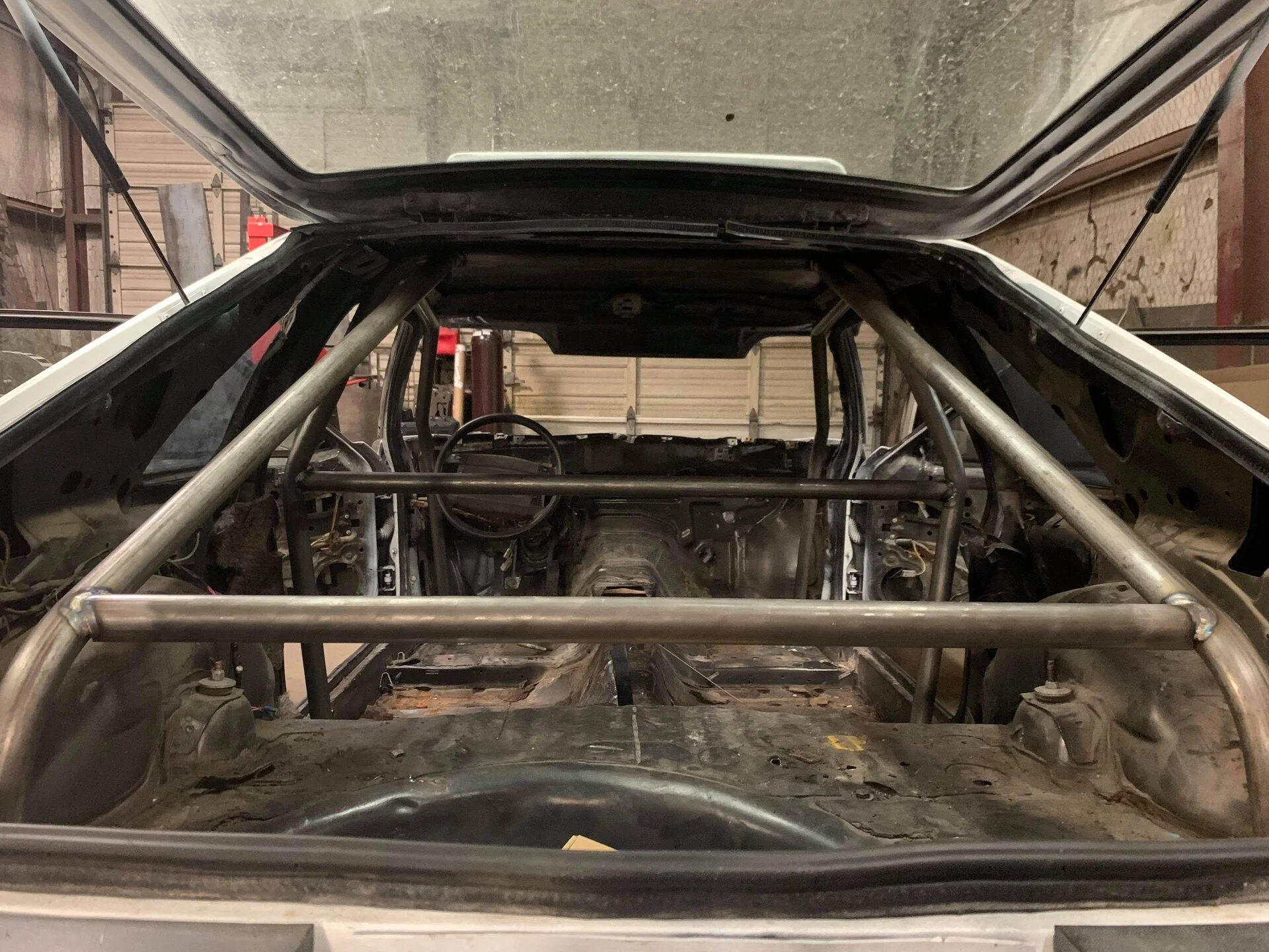

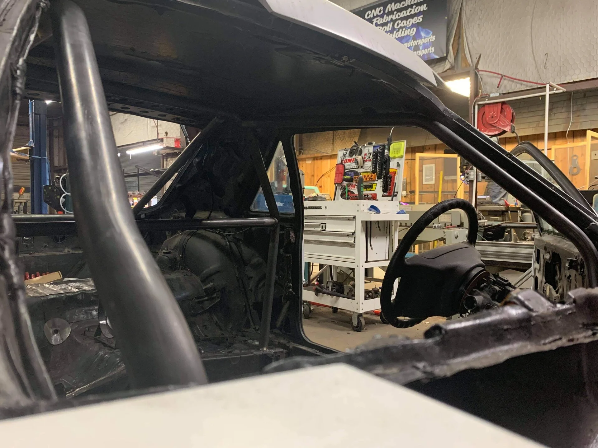

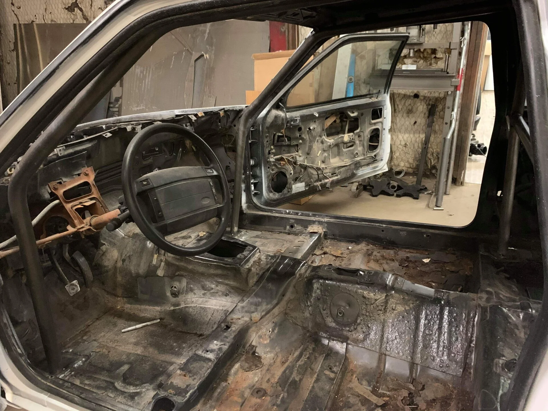

The '89 GT getting 8.5 certified cage done!!

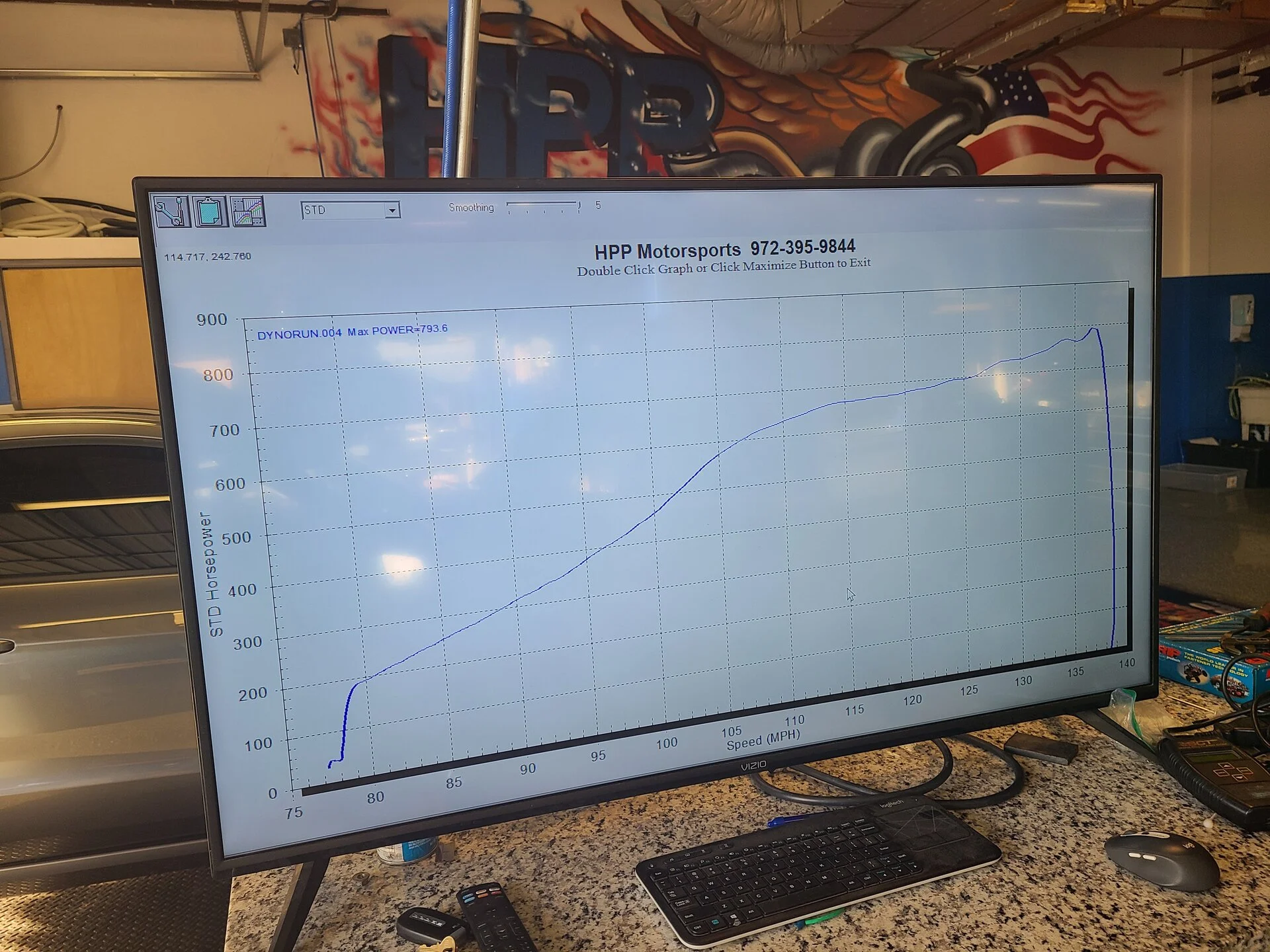

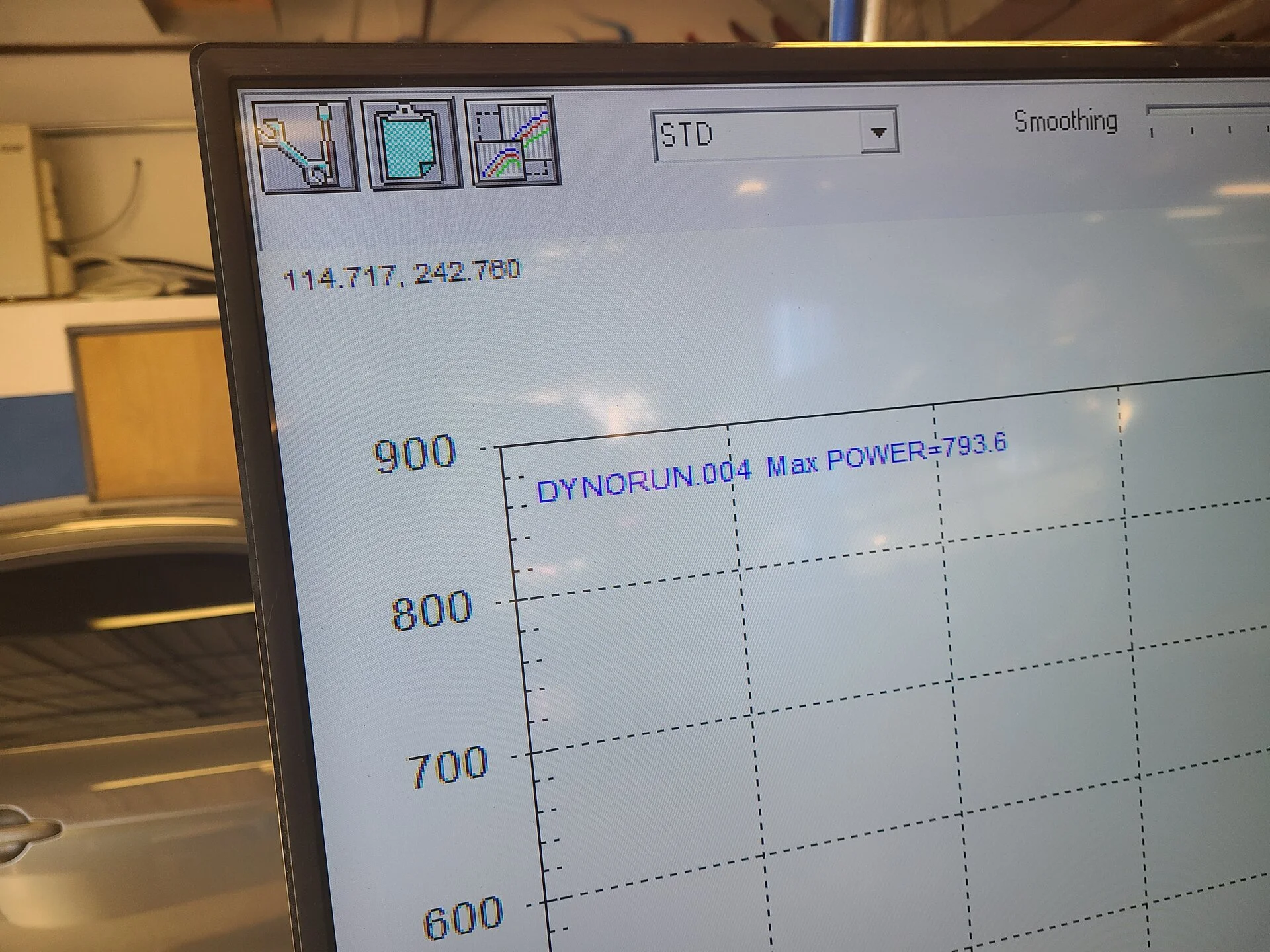

Took the reef in to HPP Racing for a tune Wednesday. Had to update the Holley HP software, set up a better cold start tune as well. Keeping the boost the same at 14lb, and got some pretty good numbers.
793rwhp at 5500rpm.

Nope. The cold start issue along with it wanting to stall while I would shift(when letting off the throttle afr's would jump to 20+) made me wanna get it tuned. Previous tune they were at 610rwhp with 15 degree's and running off the 14lb spring. With the update of software and playing with the afr, it seems very happy now. No more having to play with gas peddle while starting it.
