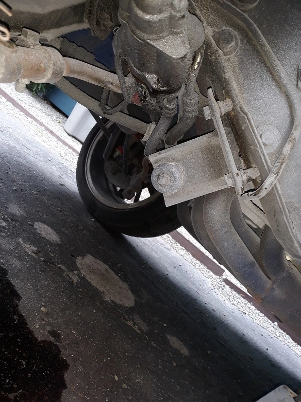

I had a power steering leak, turned out to be a loose nut on one of the smaller hoses. But I noticed this brackets ripped out from the frame. Took it apart, cleaned it n elded it on good. Now the car steers really nice, like a million times better or a normal car. Now im thinking the granada swap isnt a bad thing. Brakes were always awesome but the steering was terrible. Now its nice.
Might be worth checking on yours
