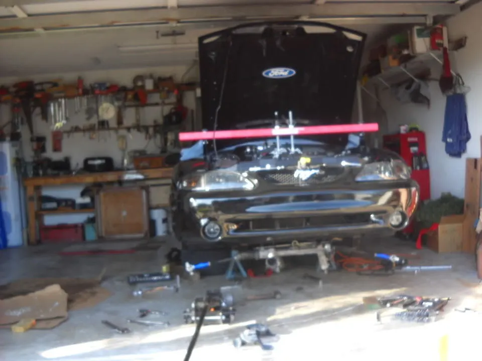

i will be driving down to UPR saturday and picking everything up!

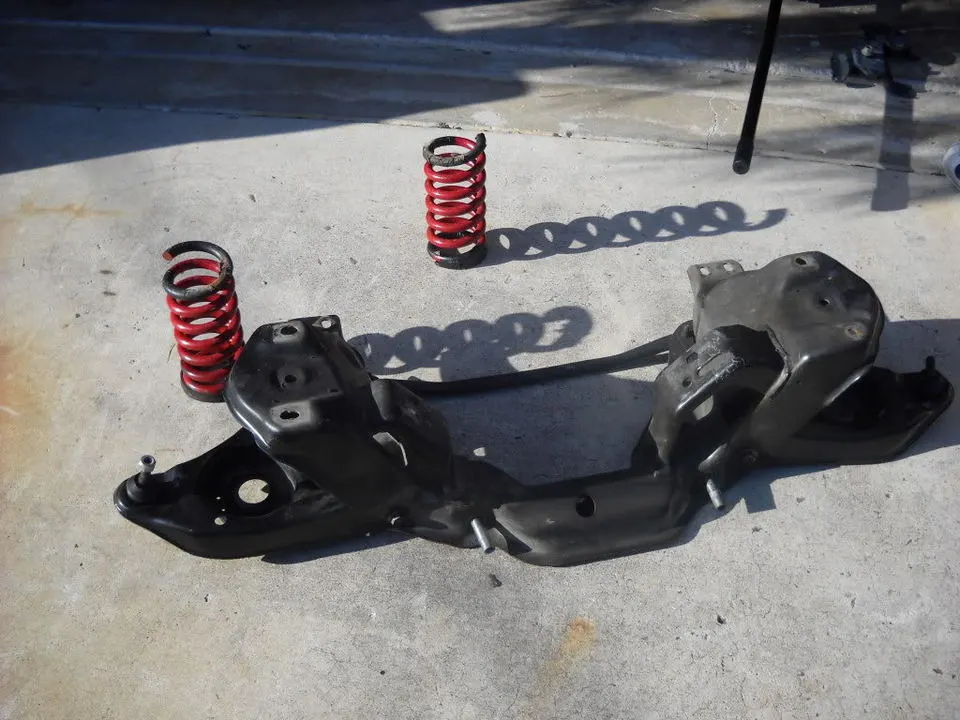

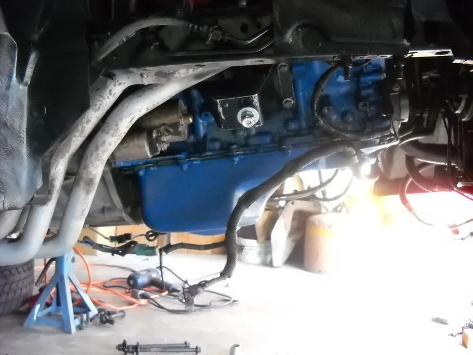

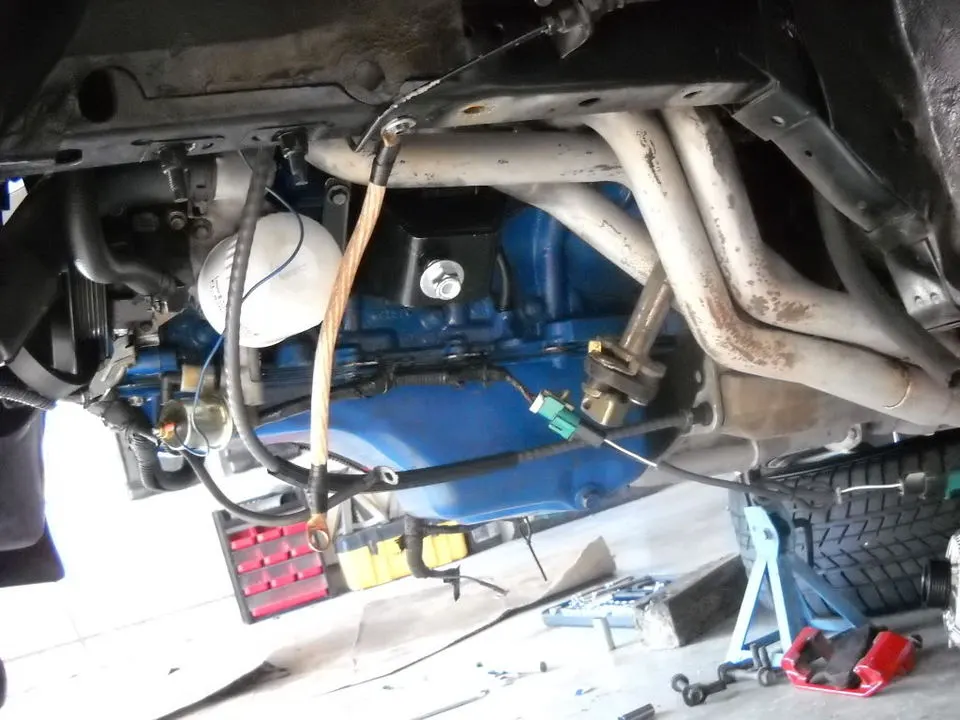

HEY LOOK!!! i got the motor mount on!:p
heavy POS

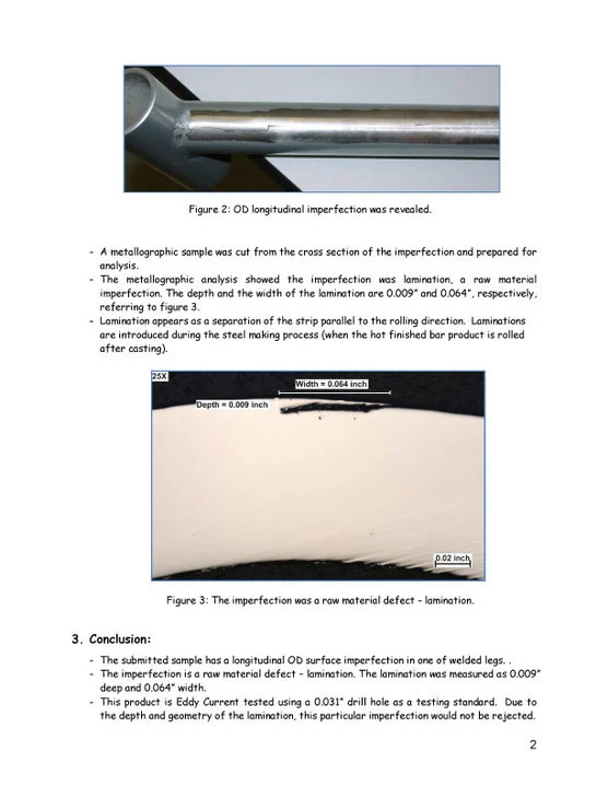

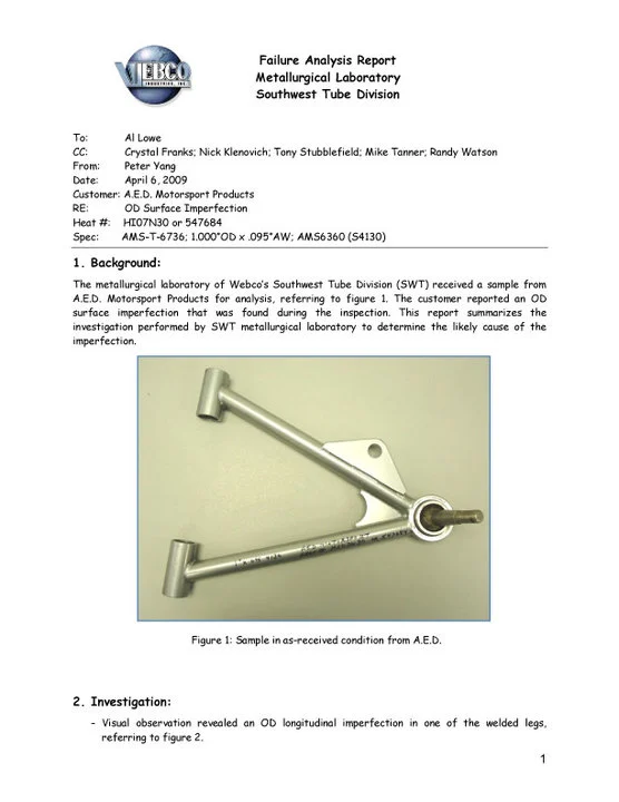

Not sure what BS you are referring to but if there is a defective part we (UPR) will take care of it.
As for K-member please show me a cracked one because there has never been one reported back to us. There was a "defective" A arm that in fact was not cracked and we even had the A arm sent to the tubing manufacturer who x-rayed the metal to see what the mark was on the arm. The "crack" was actually what is called lamination where excess metal can overlap and leave what appears to be a seam during the tube making process. The lamination was .064" wide by .009", which is quite literally thinner than your finger nail.
More importantly the customer that got this A arm was taken care. Unfortunately many people read that on multiple different forums and only read the first page and never read the rest where the customer was happy and the findings were posted to show the part was in fact not at risk of breaking.

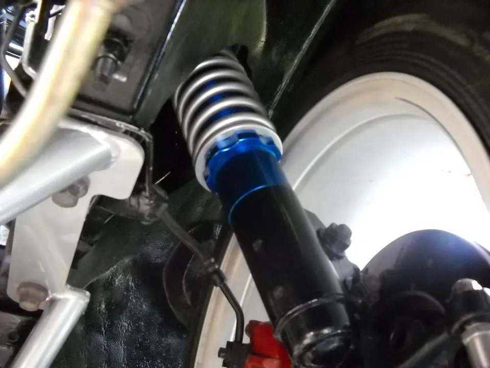

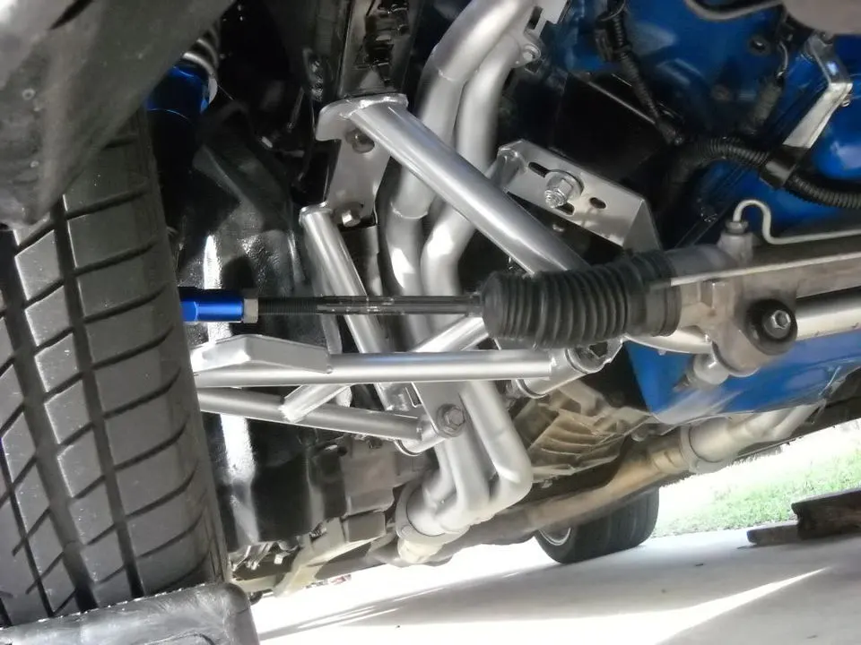

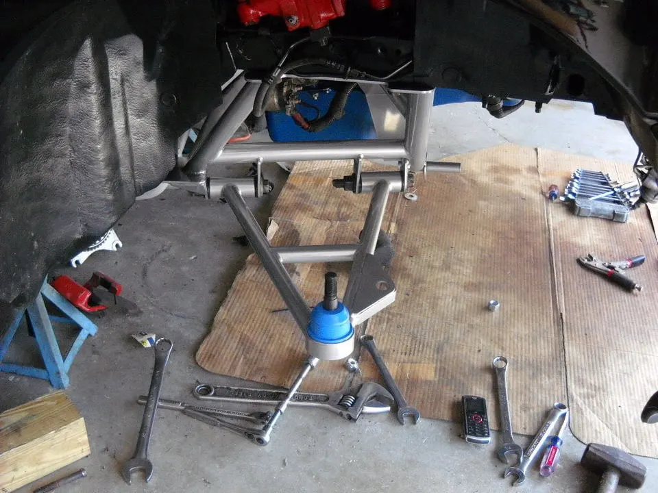

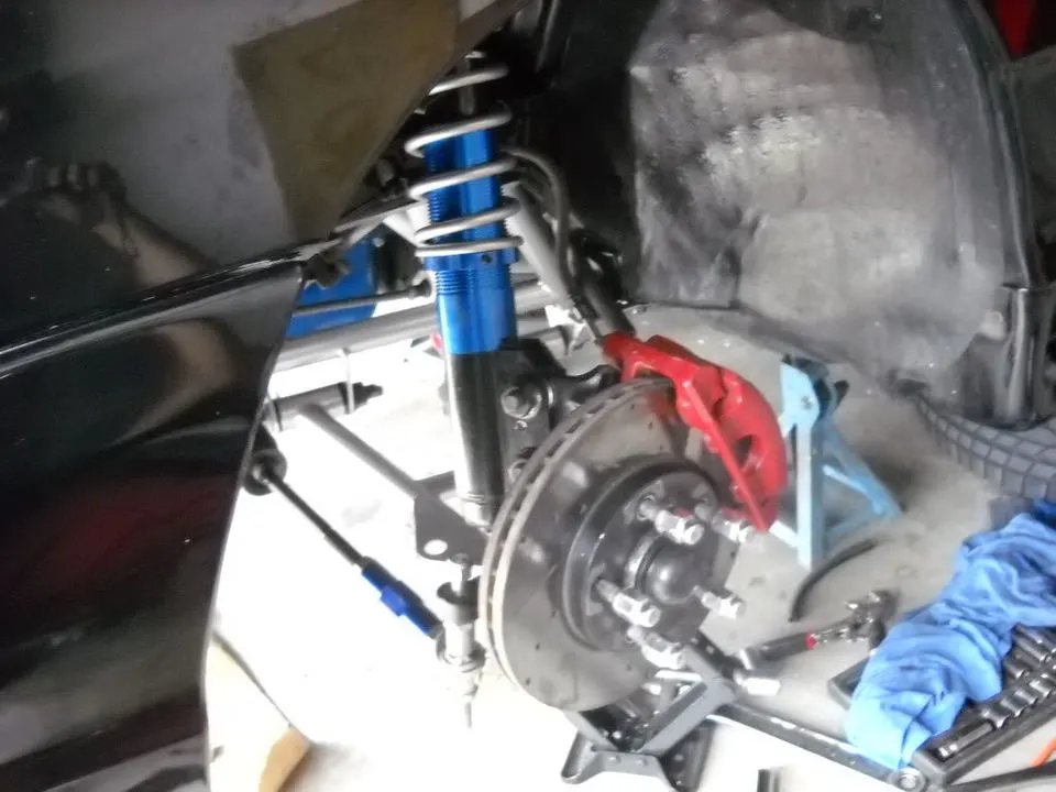

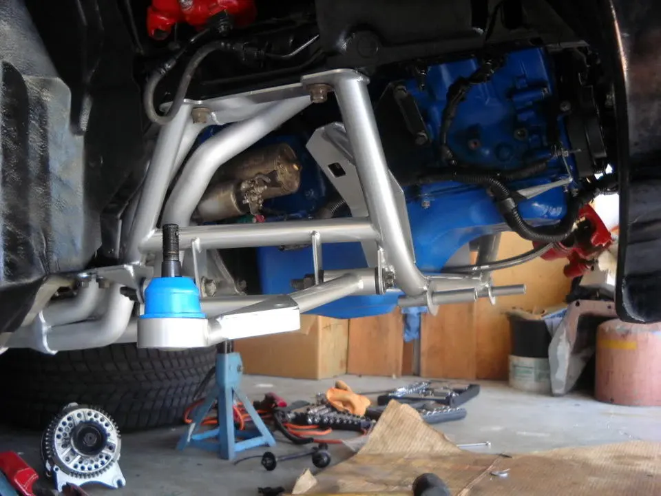

well i picked everything up today, and have been working on it since, all i have to say is that... i NOW LIKE UPR PARTS BETTER THEN BEFORE!!, everthing has went on perfect! it all fits GREAT! and the workman ship is amazing, it sucks its just going to be hidden under the car.
UPR FTW!!!!!!!!!!!!!!!
