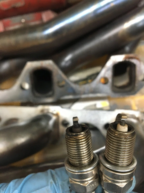

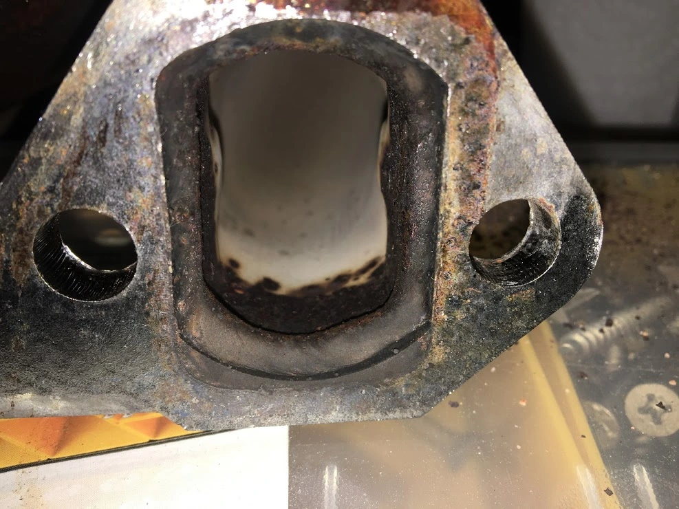

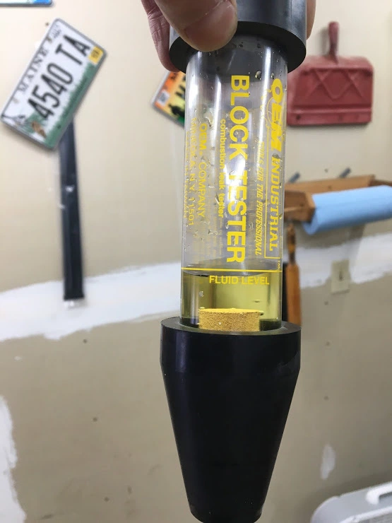

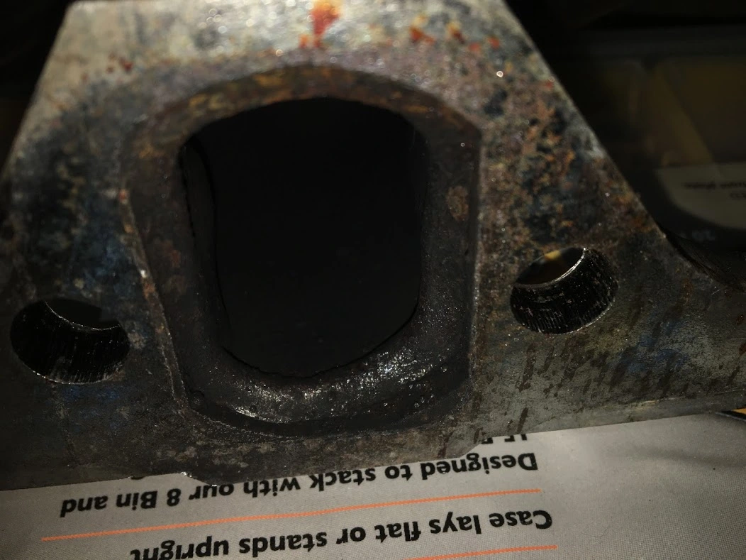

I recently had my headers off and saw a discrepency with my tubes.. cylinder 8 looked different than the rest. I'm not sure if it indicates HG, but it bothered me enough to get a block tester. Yup... no good. I have a few questions. Since i really don't know when headgasket blew I'd like to do a compression check. Does there need to be oil in the motor to do so? I just drained it to send out to Blackstone Labs for analysis. Also, what headgaskets do you guys like? I was looking at the Ford Performance Competition ones on LMR, part # M-6051-A302. Any experience with these? Also, I am not sure if this car has been rebuilt.. do i need to be mindful of cylinder bore if its been bored over?
Thanks!
(cylinder 7 on the left, 8 on the right)
Also, for what it's worth. My car never had any over heating issues.. per say. However upon first start up temp would spike to 240 ish, then immediately back down once it got there. It would remain at 180 for the remainder of the time that the coolant was warm. I knew this wasn't right but didn't think it was a big deal and attributed it to a gauge issue, air bubble, or thermostat opening slow. I did notice the coolant reservoir was dry at the end of the season and added a little coolant (radiator full) but that's when I started to suspect I had a bigger issue.

I was under the impression if it failed the block tester there was combustion gasses getting into the cooling system via a bad head gasket or cracked block? I'll take your advice to do a leakdown test though, for sure. I tried to do a pressure test after, but the kit I had didn't have a specific adapter for my radiator and the universal one didn't seal. I gave up because I thought the block test was definitive.
While I am a firm believer in the hydrocarbon testers. I have seen them be somewhat inaccurate from time to time. It is more than likely a small leak in a head gasket, but with it running like a champ and no mixing of any fluids with a barely noticeable fluid loss. I would explore other options like a leaking intake gasket washing a cylinder, before tearing it down to a short block . But I’m also kinda lazy and cylinders heads can be heavy lol

#8 huh? Well, a failed intake gasket can leak coolant into the intake runner where it gets sucked into the cylinder. In this case the car may still run fine. The coolant gradually leaking in cleans the carbon out and makes that cylinders plug look clean like yours does.
