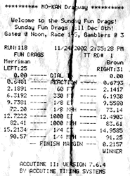

Here's the closest timeslip I have scanned... I'm on the right.
60ft is almost as bad as yours. :nice:
1/8 mph is 73mph like yours. :nice:
1/8 ET is close. :shrug:
I don't spin at all off the bottle. On the bottle I can hit the juice a foot off the starting line and they'll only spin a few feet.
I'm hoping a good stall will fix this. If you are spinning, your bald tires won't ever give you a good time. Get some better ones. My Essenzas are great for street tires... they need a little heat though.
