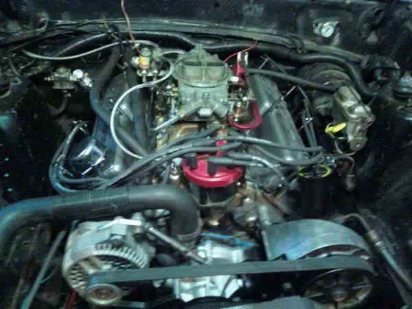

Whats the combo consist of... Picture looks great and numbers look good as well!
thank you sir.

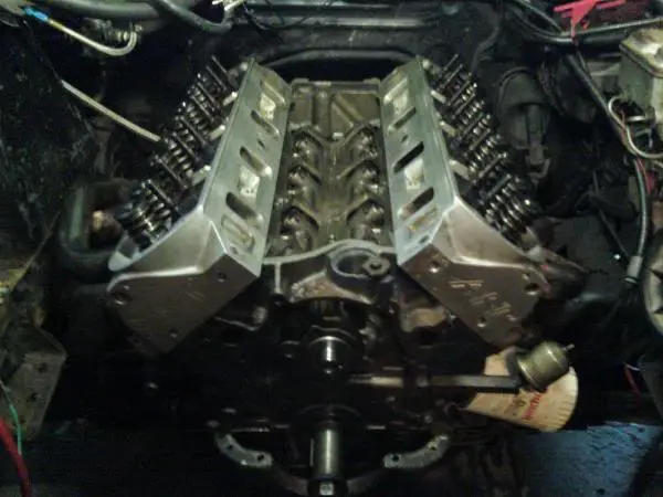

stock bottom end 302
high volume oil pump
Anderson Ford Motorsport N41 cam
Crane "high rev" Lifters
Manley 1 piece chromoly pushrods stock length (6.500'')
AFR 165s
Scorpion 1.6 RRs
Victor Junior intake
Holley 600cfm Double Pumper (factory settings still, that will change tho)
BBK longtubes (ran em open for the track)
BBK O/R X-pipe
dumped flow masters
C4 with all the goodies, transbrake /3500 nitrous converter / billet servo/rollarized input/ kevlar clutches and whatnot.
trans cooler...yada yada.
3:73 gears...stock posi unit/ stock axles with 28X10.5 tires.
ohhh and a 150 shot of NAAWWWWZZZZZ

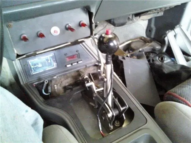

i plan on upping the gear to either a 3:90 or 4:10. i was barely hittin 6k rpms at the stripe.
also probably gonna get a different sifter cuz i keep slamming it into 2nd off the line, haha.
i want to get a bigger carb too, probably gonna go with a chokeless demon 650 or holley HP 650.
Any NA times from the car? Looks like its a strong running street car!
ya a 13.1 (babying it on its first pass) and a 12.6 off the foot brake, but then i checked the timing and it was at like 4 degrees advanced. haha. so i bumped it upto 12 and gave it hell on the juice and brake.:p
im sure it would run low low 12s or high 11s on motor with more timing and on the brake.
