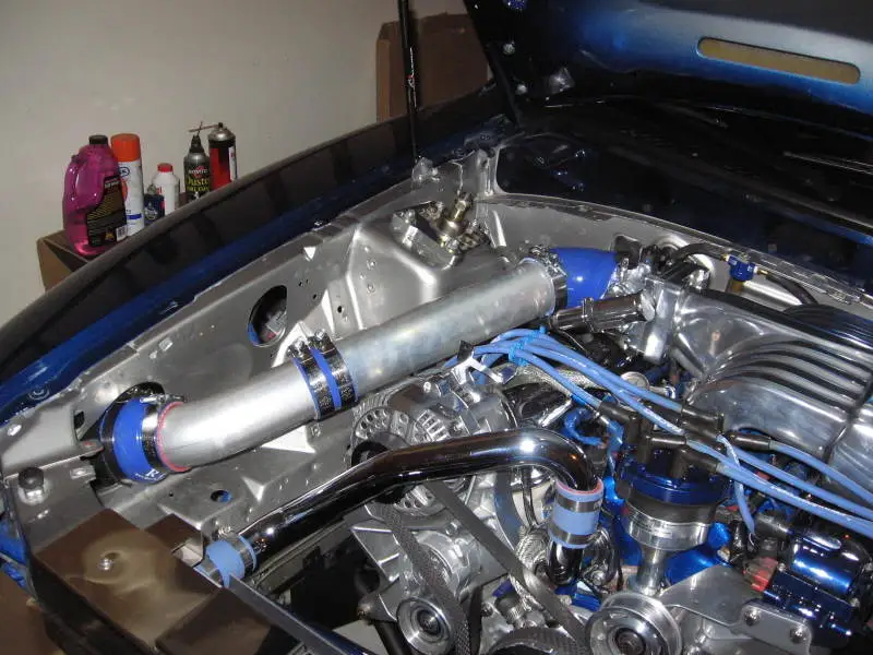

I used 3" aluminum tubing and some silicone couplers. The meter is in the fenderwell with the air filter. Since the pic, I had the tubing chromed and trimmed the couplers more...
