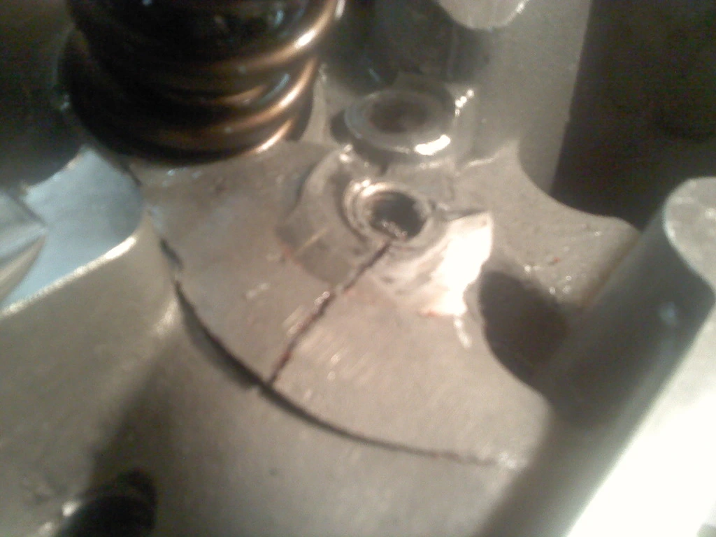

procomp heads.. snort. The owner of the company buys from different sources so who knows what heads you are getting. They used to be Speedmaster, Patriot and about a dozen other names. I've seem to many horror stories of leaking water, crooked valve seats or guides,aligment problems.stud holes drilled through the head.. and on an on
