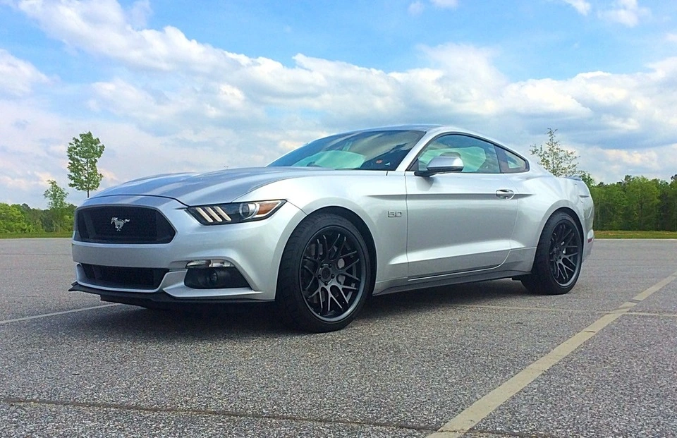

I have a 20x10" wheel on my car with 275/35/20 tires. Personally I think they fit and look great, with that being said I can imagine that the 285 will fit. There is a surprising amount of room in the front even with the 10" wide wheels.

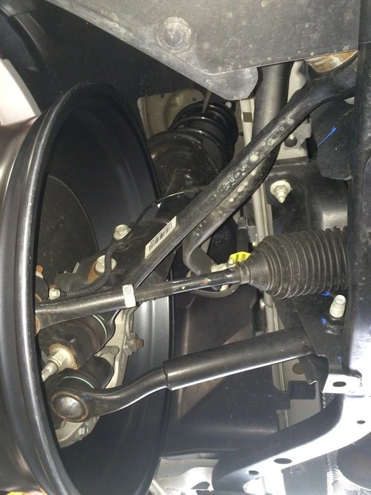

The 275/35/20 fits the front of the car perfect. I won't NOT go wider than that on a 10" wide rim.
Between the wheel and the shock body I have about 1/2 - 3/4", just enough to slide a finger between them, which is kinda my minimum clearance for wheels / tires / other components.

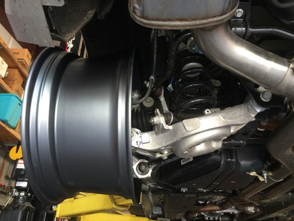

Here is the test fit on the wheels.....20x10's, 40mm offset, 7.0" backspacing...they fit, but I would not be comfortable even a hair wider....

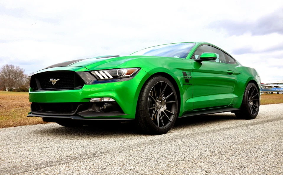

And, all mounted up with 275/35/20's all the way around....
