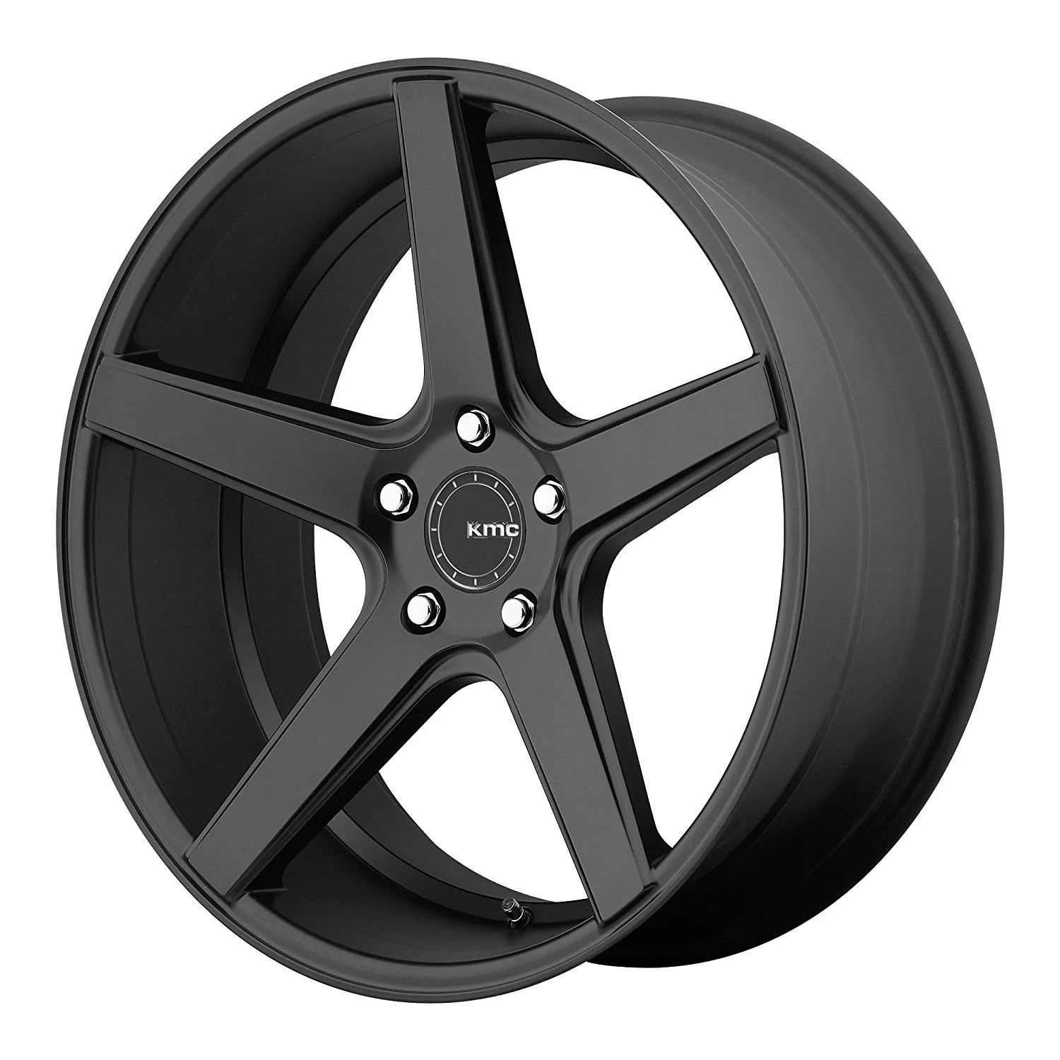

What kind of wheels are those? They look great!
The 275/35/20 fits the front of the car perfect. I won't NOT go wider than that on a 10" wide rim.
