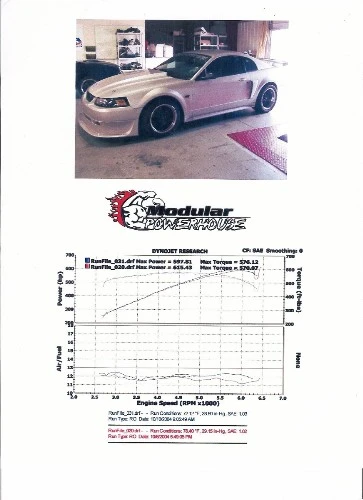

I had Comp cut mine with specs from Dennis Miles there. They were on my car with the t trim, jt trim, 1.7 KB, and the 2.2 KB and worked fine with all of them. I also used the comp springs and ferea valves with all else being stock in the valvetrain. Here's the graph although I don't think it's very readable.

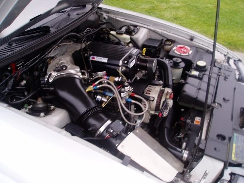

Screwd2v what MAS meter and intake do you have on that 2.2.
Thanks,
Cory J.
I was using the SCT Big Air MAF and a stock 03 cobra inlet with a steeda cai on the end of it.

Screwd2v,
How much was that Steeda CAI, any fitment issues with shutting your hood?
Also, I was looking at that picture of your engine bay :drool: lol
On the driverside front, is that a vortech intercooler resevoir? If so, is it higher capacity than the stock KB and were there many modifcations for mounting it there?

I think $200 or so for the cai........no fitment issues that I remember but I had the steeda hood also.
That is a vortech reservoir. My sole reason for using it was that I hate the bobo tin can that KB supplies in their kits and I also hate where they position it. The vortech tank requires a trunk mounted battery, that's all.
