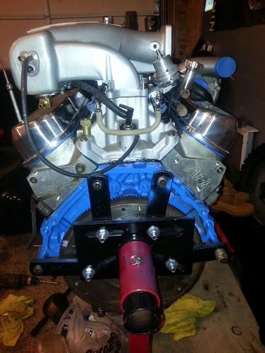

elarm1

Man that looks awesome. You need to pull your flywheel back off and hang your index plate tho.
Boosted92LX
Dec 19, 2010
5,721
4,244
224
Nov 17, 2014
#16
  • Nov 17, 2014
  • #16
You're gonna hate pulling it back out of the car if you forget..ask me how I learned that..

Thanks guys for the compliments! I too just look at it with a bottle of beer! @Boosted92LX Yes I shot myself in the foot. I'll take it off tonight and get her right but I sure missed that one! After I finish tucking the rest of the wires and painting my engine bay, the motor should be put in. About 2 weeks or so.
