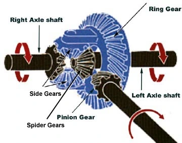

Took it apart today and found some chunks floating around and there are several damaged teeth in at least one spider gear. Its kind of hard to tell without cleaning all the fluid off, but I think the damage is limited to the spider gears, possibly the side gears. The ring and pinion dont appear damaged.
more: http://s34.photobucket.com/albums/d131/triggzzz/Differential Damage/
if you dont know what you're looking at:

SteedaGTJ22 said:
hmm thats interesting. Did you have gears put in recently that the install went wrong on? :shrug: I dont see how something like that could just happen
I have 40,000 miles on the gears and no problems. Maybe the main cap bolts have backed out and caused slack somehow? :shrug:
