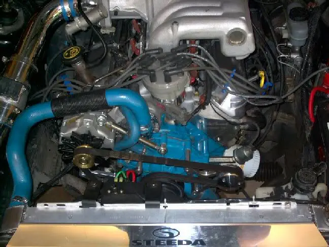

This is the setup i'm running its made by march and has a ribbed idler pulley....kinda bad picture

That is similar to the system I cobbled together:
But like I said I am not sure if I like it or not. :shrug:
I would feel better about it if I could get rid of the smooth tensioner pulley.
Pardon the dust it is a work in progress.
