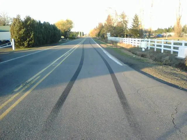

What do you do with a turbo mustang on your first dry day in 2 weeks?....
