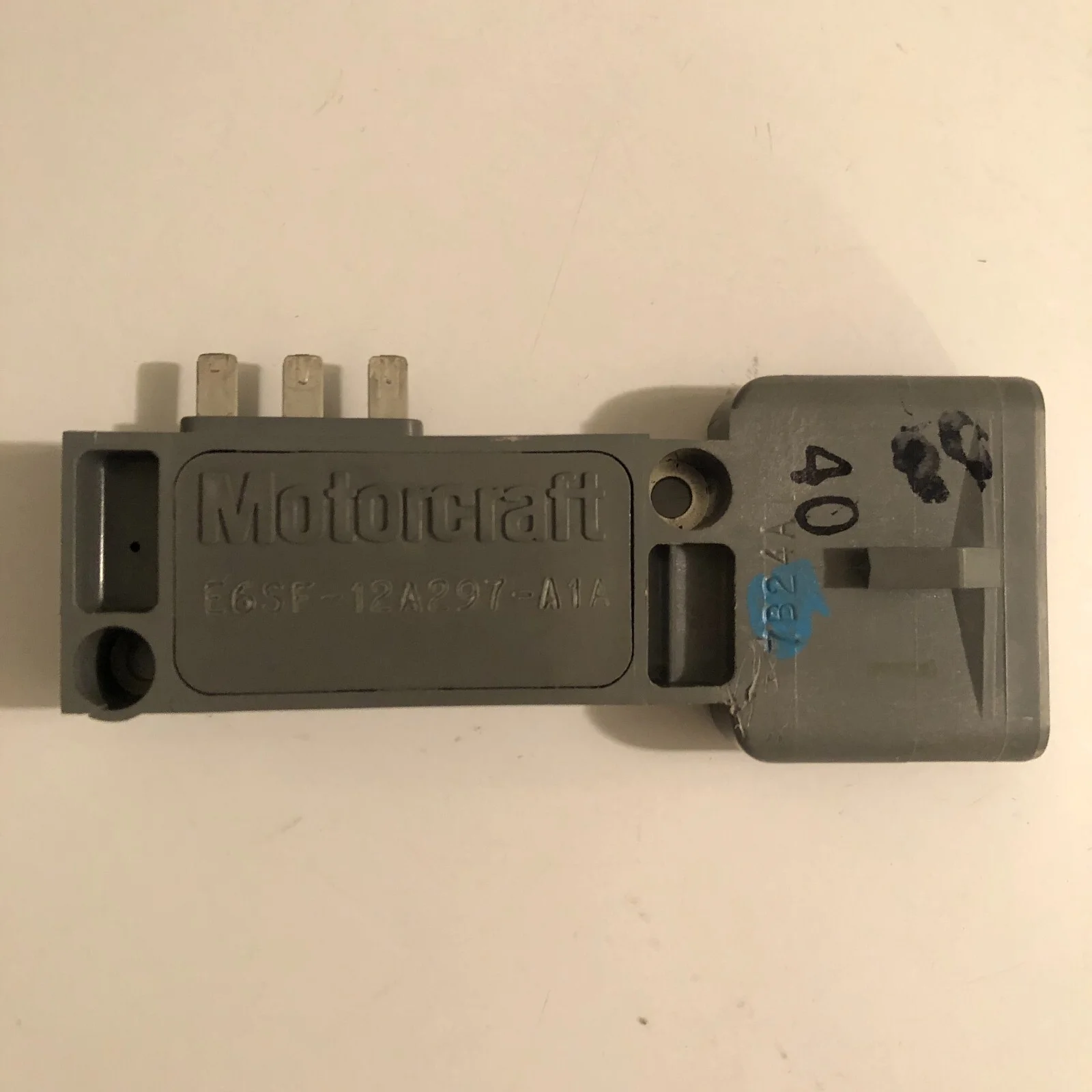

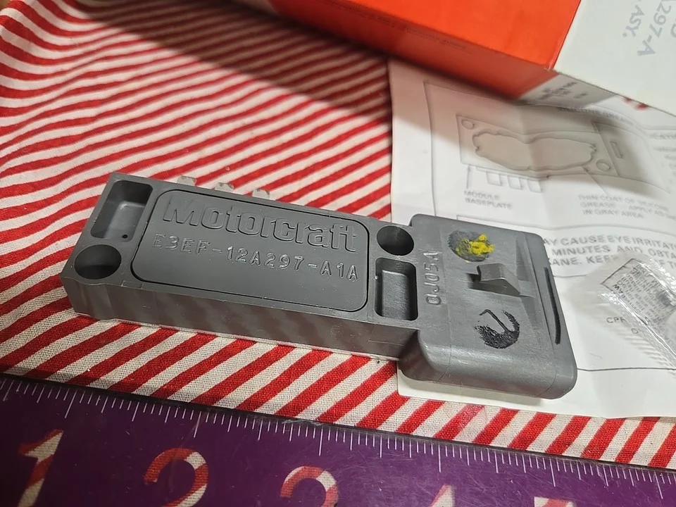

for an 87-93 foxbody 5.0 mustang.
E3SF-12A297-A1A or E6SF-12A297-A1A​
what is the difference?​

There are gray and black modules:
Thing I have determined is the gray module is what we want to run.
The TFI modules for automatics and manual gear boxes are the same.
Reactions: Mcmahst
I believe there were different part#s for auto and manual,but not sure why.
I do know that A1A means that it is for manual transmission and if it ends in A2A it is for Automatic transmission.
I am currently using the OEM E6SF-12A297-A1A TFI module on my 1991 Coupe 5.0, and it runs so smooth all the way to 5500 rpm like butter...​
