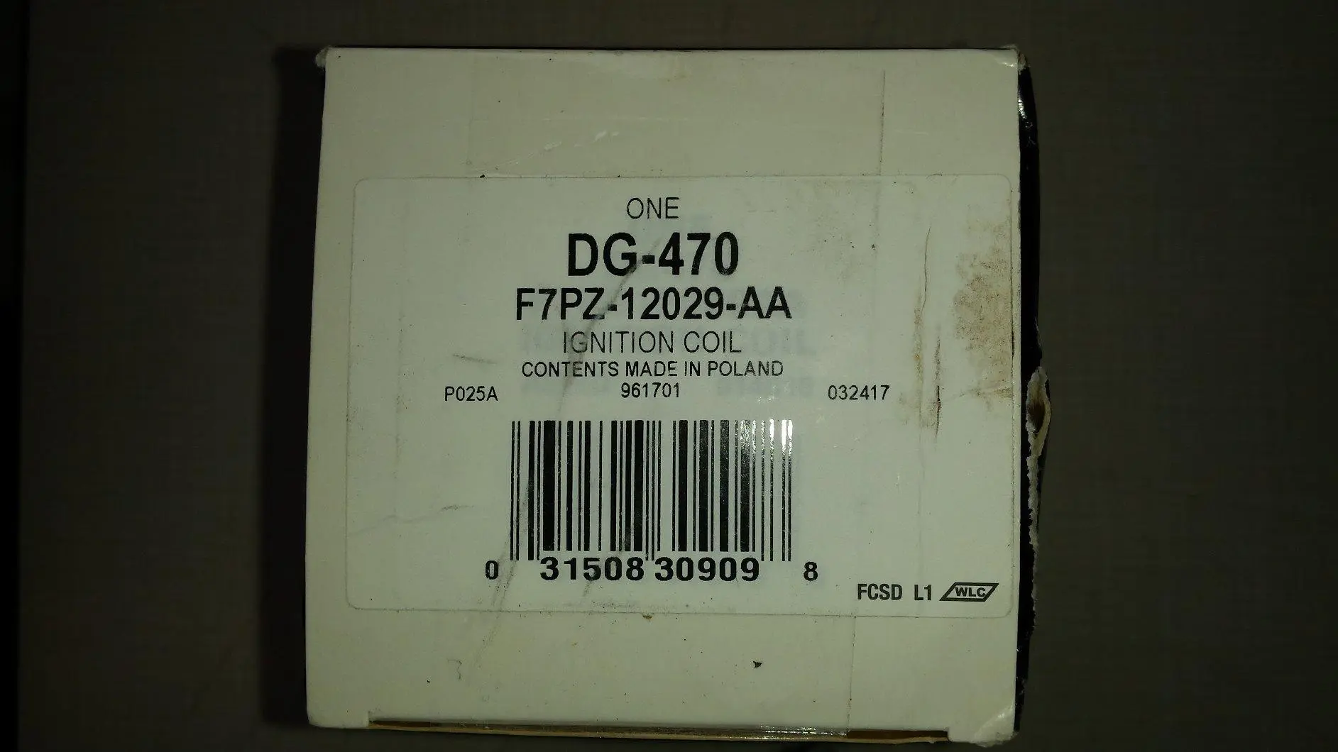

msd coil probaly cooked the tfi and left it with a bad trace connection, avoid china e coil's. There windings are trash. why I just use smp vs motor craft, better warranty pretty much identical parts since they have the current contract for ford... Everyone can get the newest motor craft tfi, but you if you can buy local under smp with a better warranty and walk in replacements vs mail order, its the better option.. Heres the current motorcrafts coil... Notice made in poland, thats because its from smp where they make the blue streak line. only different motorcaft has a tin coated terminal vs brass, lesser warranty and higher price. Only du30c pick ups are obsolete from ford so smp lx222 for those. These cars are getting old, gotta find electronics you can still trust.
Agreed . I’m sending back the msd coil and buying a motorcraft. Appreciate the replies and the information you’ve shared. Thank you!
