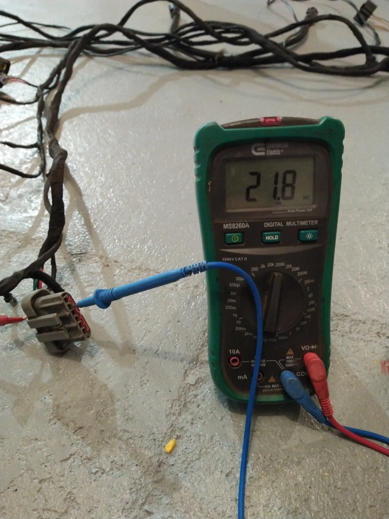

The cause for the overheaing TFI module is usually caused when the resistor on pin #4 coming from he ecu burns out or in technical terms shorts to open ....The unfiltered power the ecu and TFI gets on that circuit is a no no and way too much thats why its limited to 22kohms using a resistor on 88-92 or 93 5 speed models.......
A test between pin 4 on ecu plug and pin 2 on TFI plug will reveal if it needs to be replaced if its an original 5 speed car and if its not an original 5 speed and originally was an automatic the 22k resistor needs to be added especially of you put a non CCD TFI module on your dizzy.....

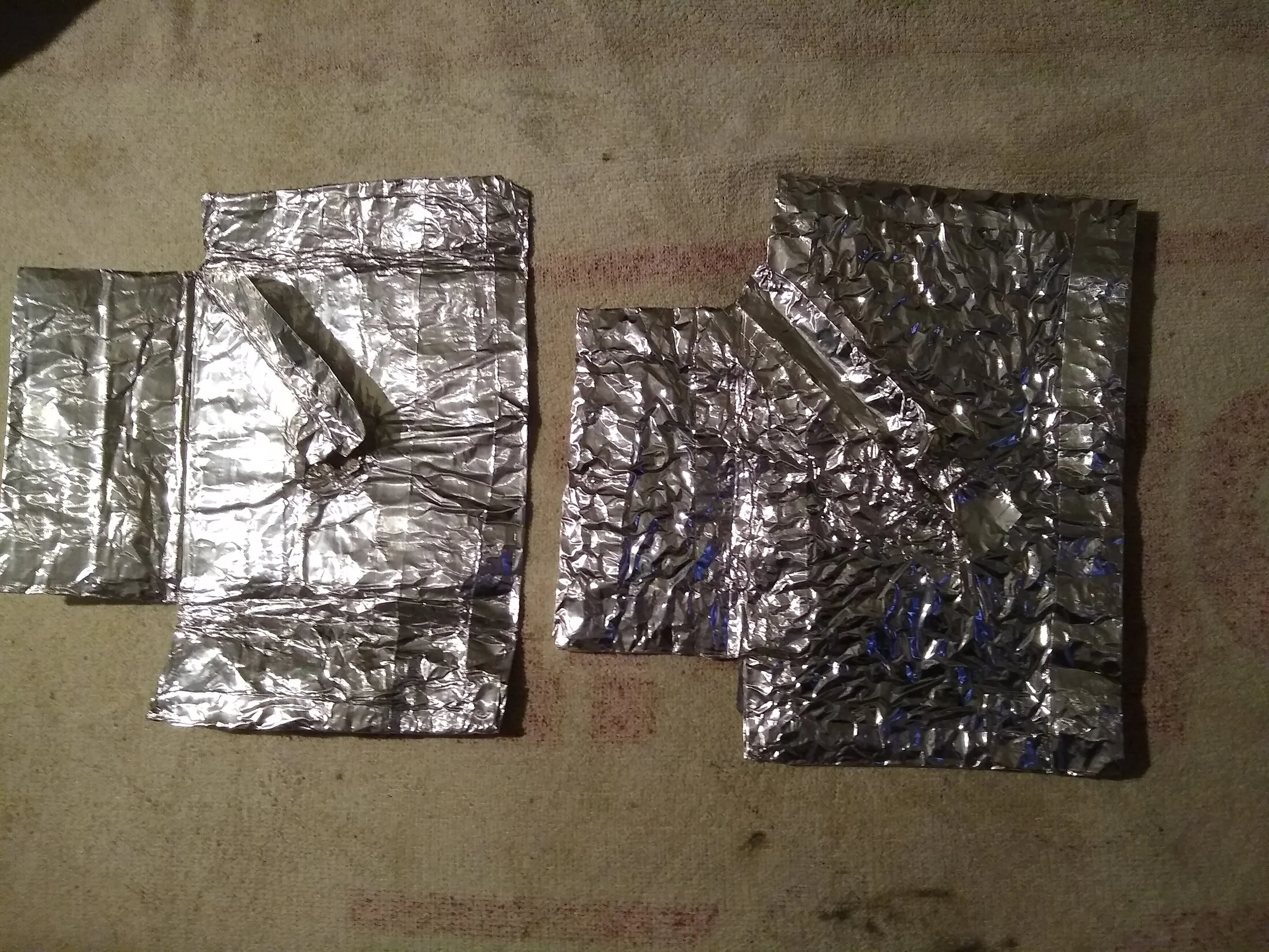

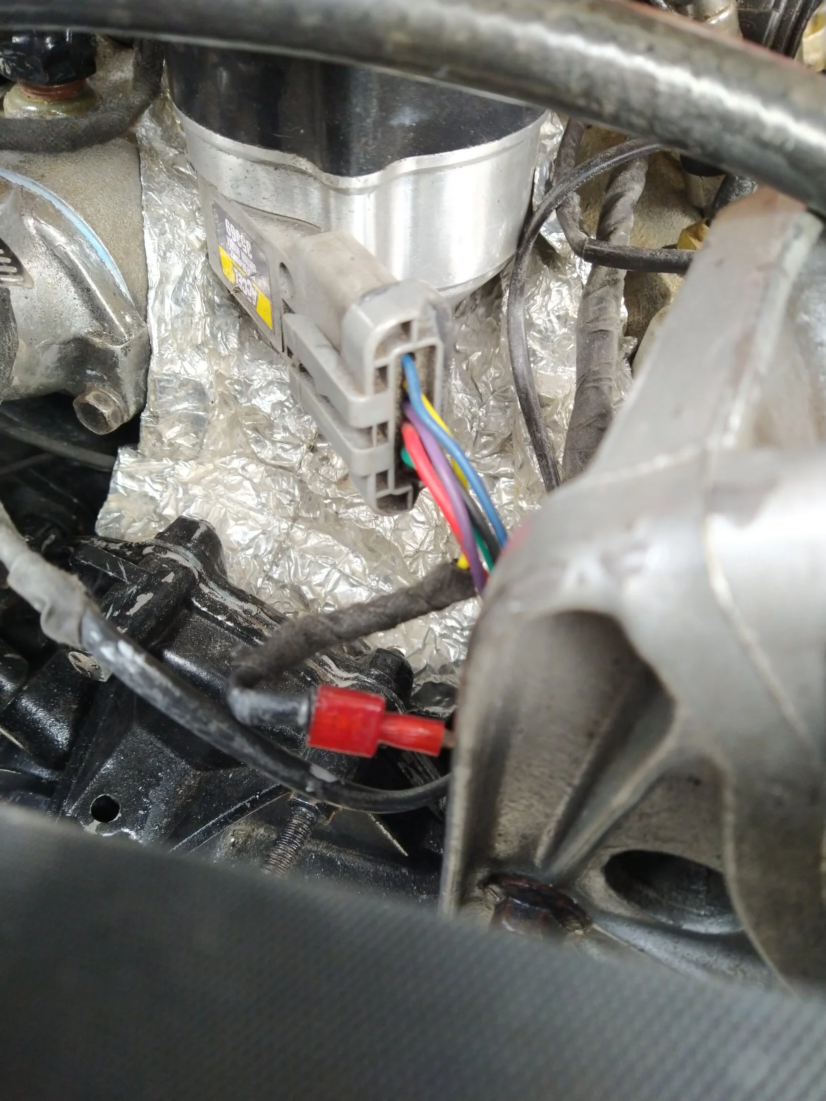

Whats funny is for anyone contemp;lating doing the TFI module relocation mod just know that with a piece of simple foil faced insulated bubble wrap and some foil tape to make it more resilient I made a shield that keeps the heat from rising up under my TFI module and It works pretty awesome...
I used an old intake and distributor and some peel and stick with foil tape to prototype the first one...

The cause for the overheaing TFI module is usually caused when the resistor on pin #4 burns out or in technical terms shorts to open ....The unfiltered power the ecu and TFI gets on that circuit is a no no and way too much thats why its limited to 22kohms using a resistor on 88-92 or 93 5 speed models.......
Whats funny is for anyone contemp;lating doing the TFI module relocation mod just know that with a simple foil faced piece of bubble wrap and some foil tape I made a shield that keeps the heat from rising up under my TFI module and It works awesome...
