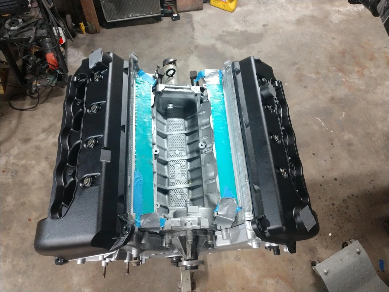

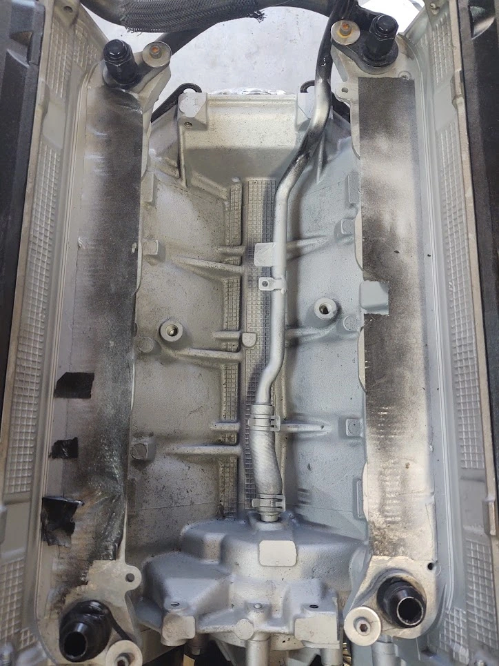

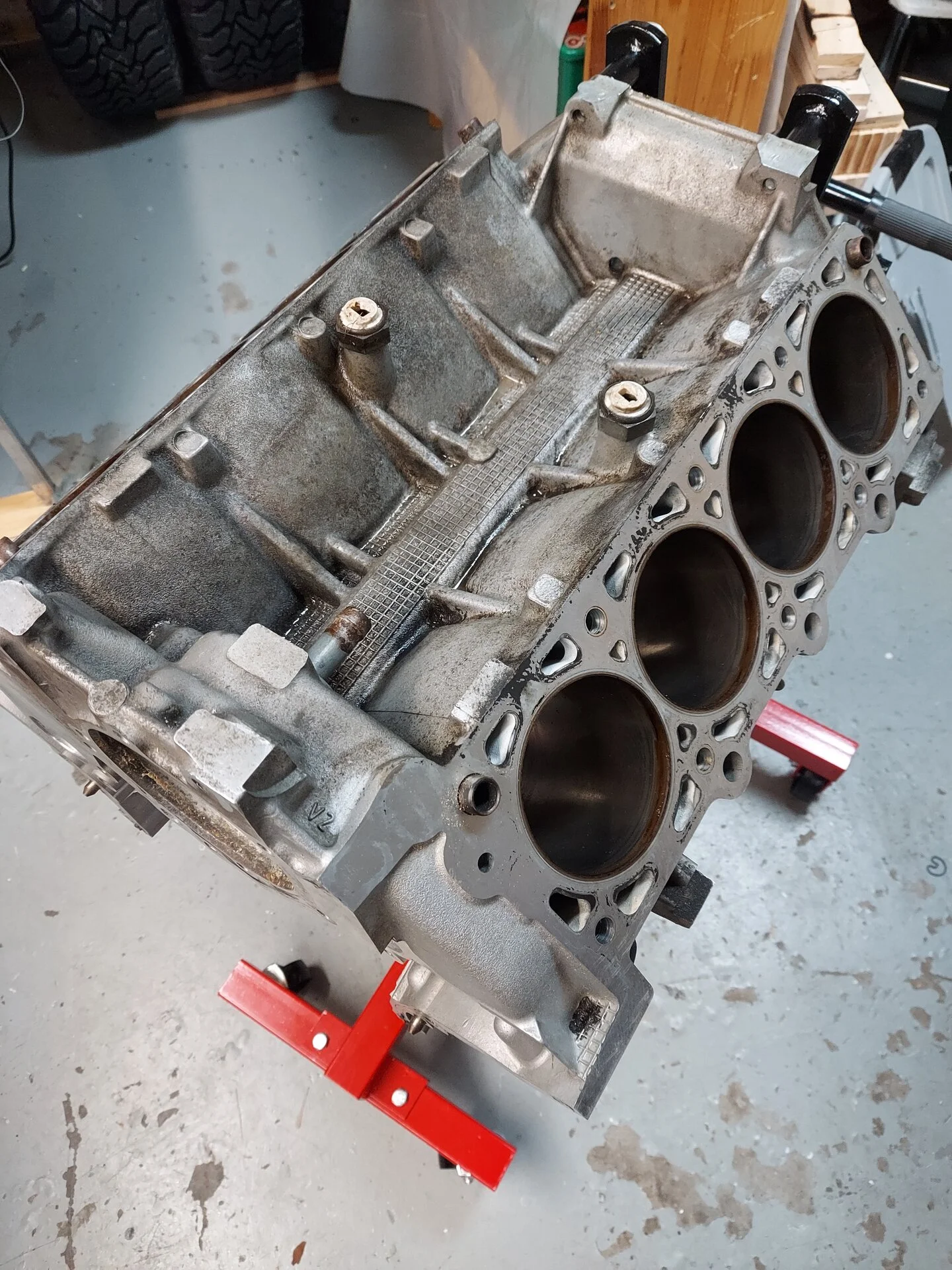

What engine is this exactly?

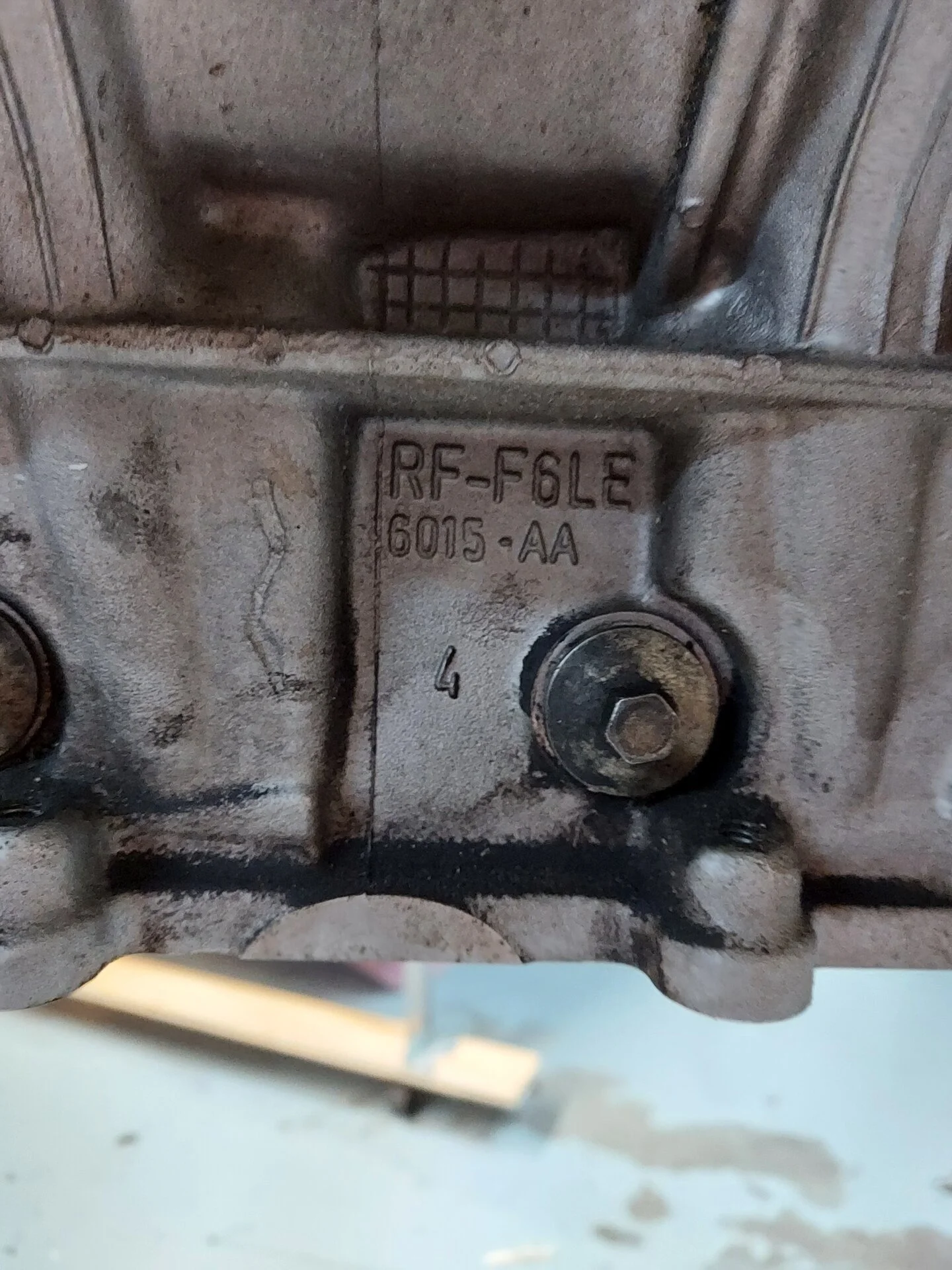

Looks like a Teksid 4.6 block, which would put it in either a 93-98 Lincoln Mark VIII or a 96-99 (Maybe 01, I forget the exact cut off) Cobra. The casting numbers on it should come back with the correct version.
