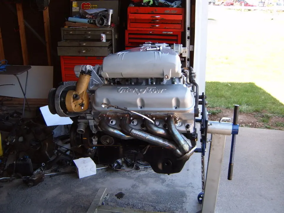

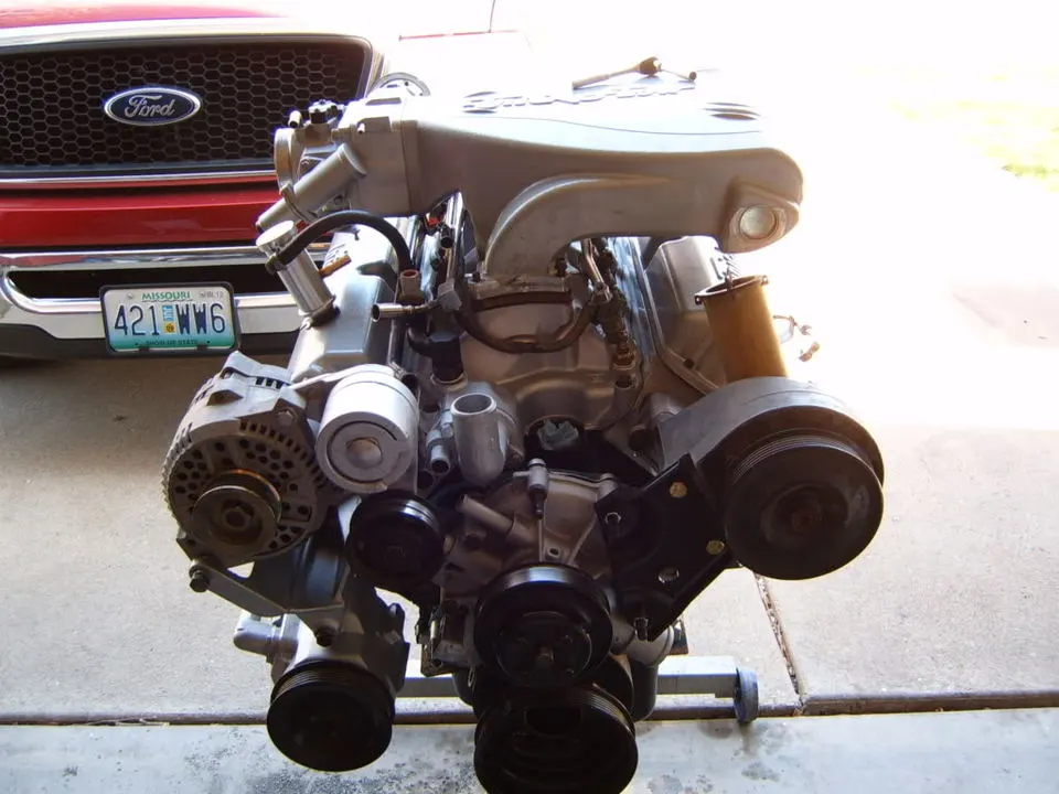

i was doing some work on the car the past few days, changing water pump, etc, and also putting in some new header gaskets. drivers side went fine as it should be, and of course when doing the passenger side theres the tubes that im guessing are part of the smog pump in the way. removed the rubber lines and the one going back to the headers, but there was still the one going to the back of the heads. bent it a bit to get it out of the way and one end of it broke off, and of course its right where it T's into the line going to the head, preventing me from just patching it with another short piece of rubber. question is what exactly does it do, and how would i go about fixing it? pics below.
where it broke:
what was there:
