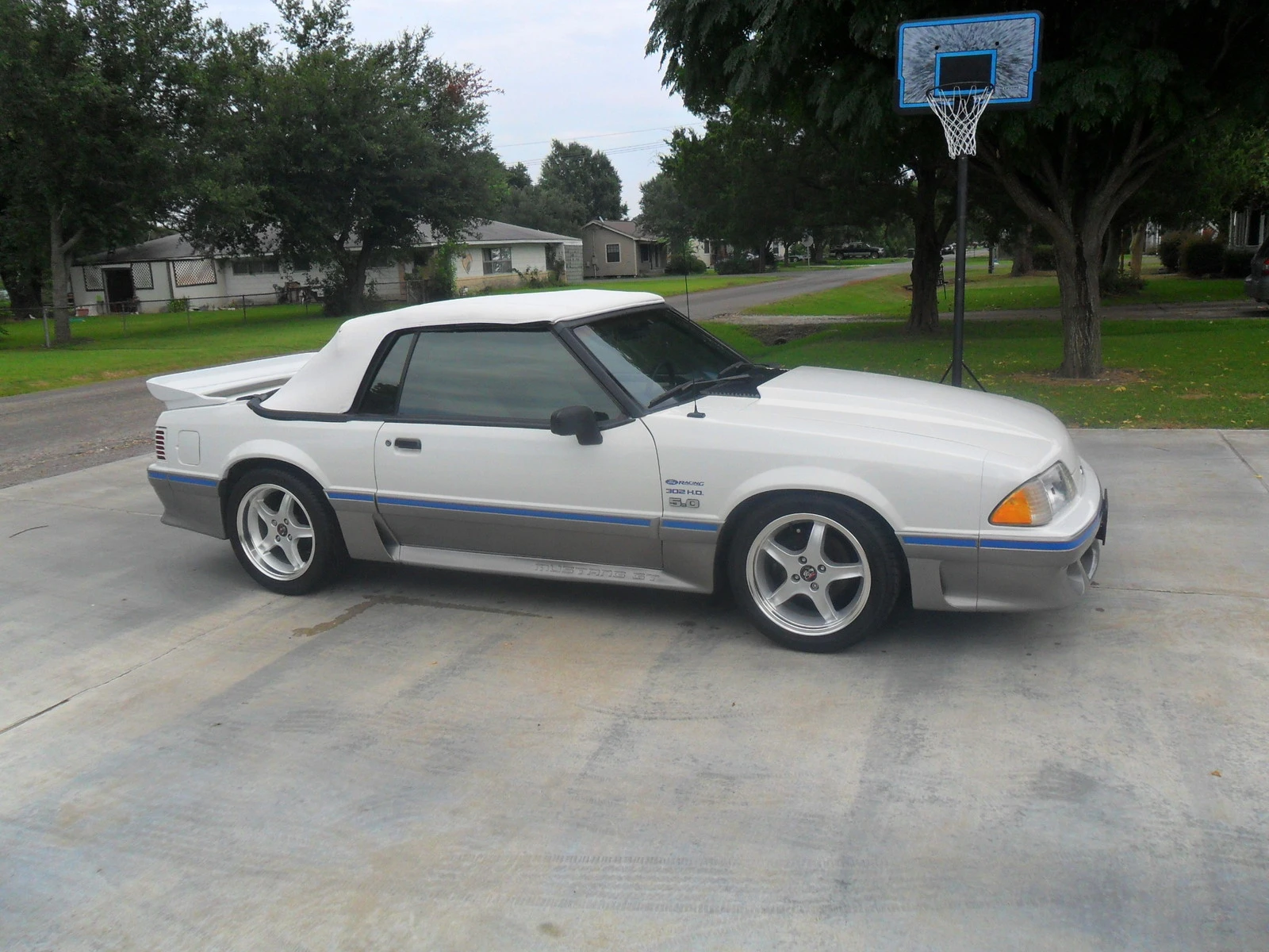

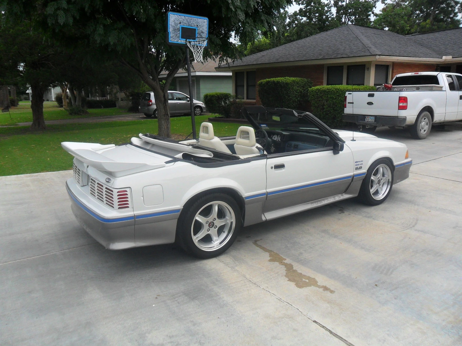

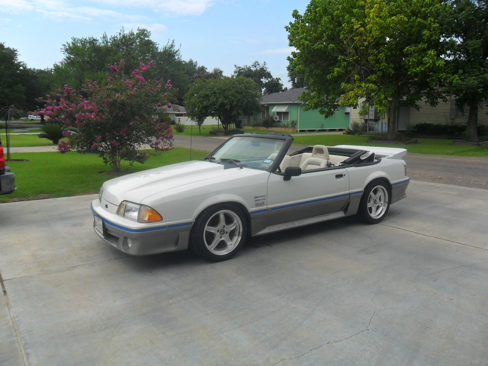

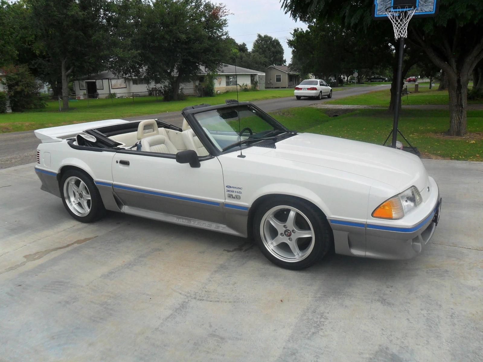

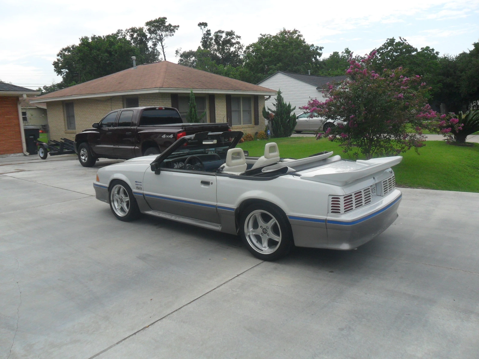

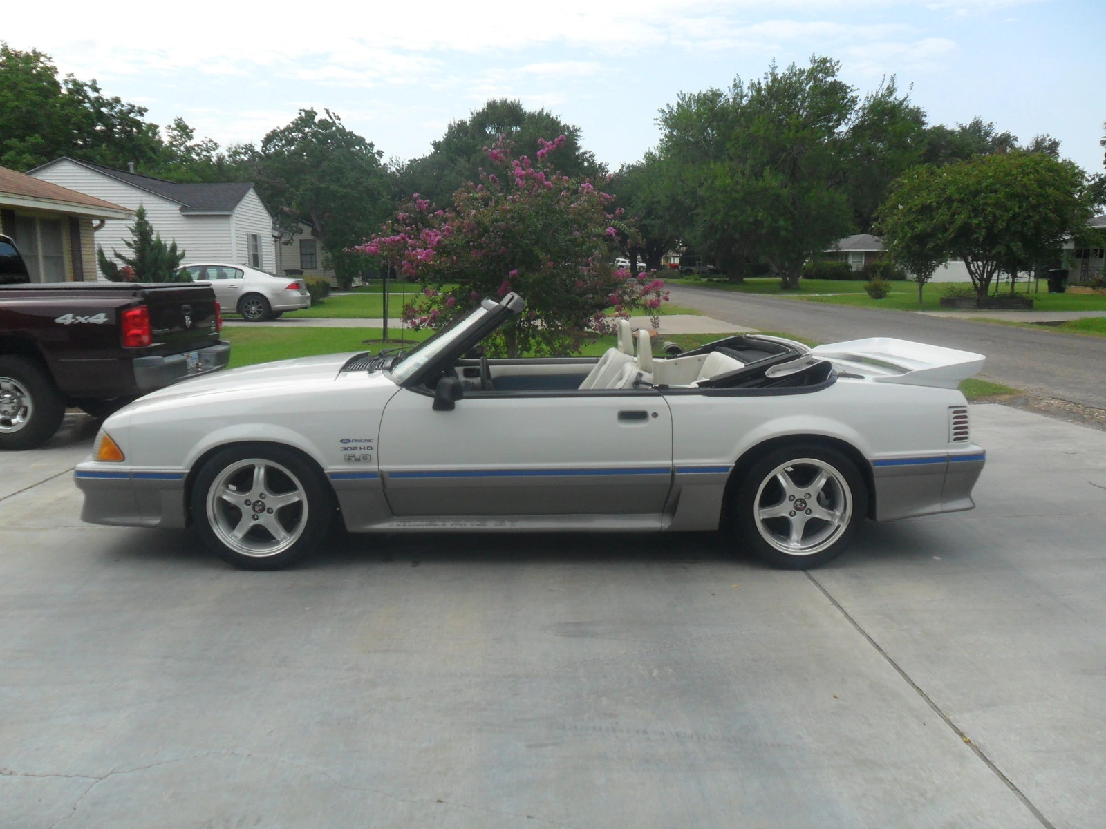

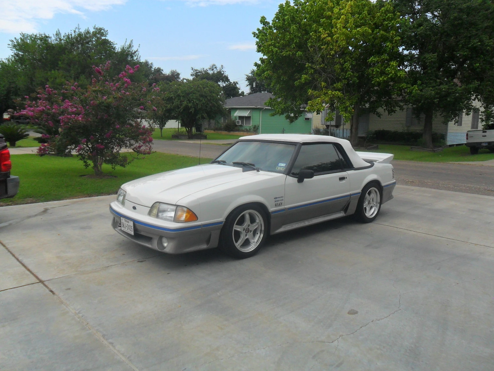

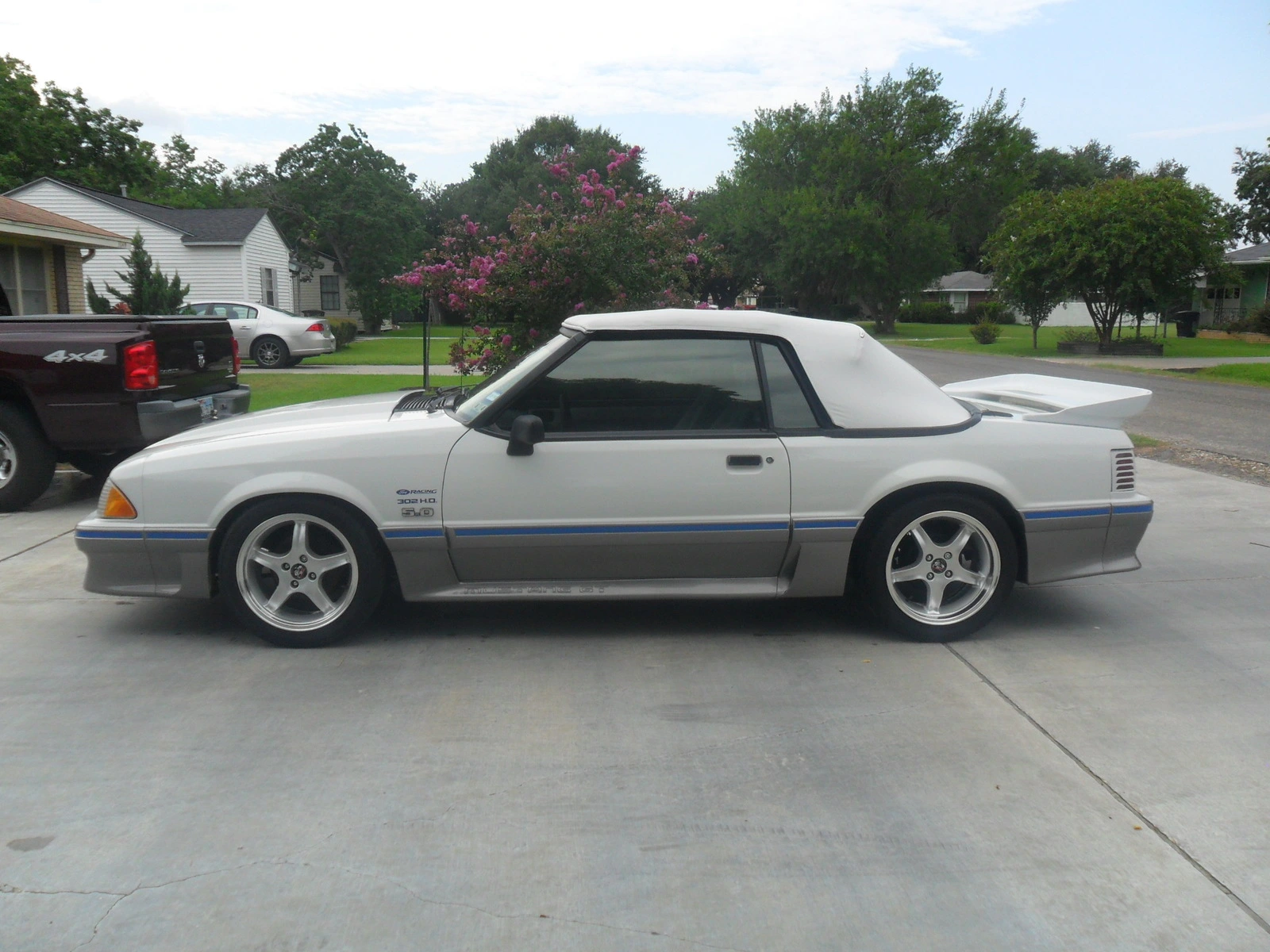

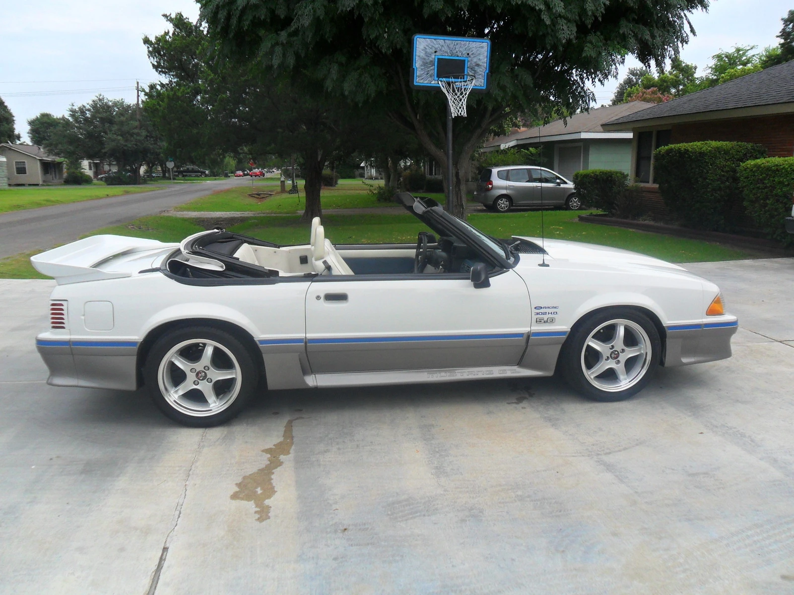

Ok, I'm going crazy. I have an '89 convertible GT with 17 x 8's with 235/45's on the front with Falken 452's, and 17 x 9's with 275/40's on the back with Falken 451's. The 451's are better looking tires, but they don't make them anymore, so I had to go with the 452's on the front. I just put the Eibach Pro Kit lowering springs on it. The back looks good, but the front looks too "bulky", and the top of the tire goes up in the fender. And the front also rubs a little when I take a corner. What brand tires look the best? And what size? I've heard 245/45 on the front, but the 235/45 are already rubbing. Thanks for any help.
I run coil overs on the front and have them set as low as they'll go, run a 9 inch wide wheel with a 255/40, and all I rub on is the inner fender well. Mine don't even come close to tucking up inside the wheel well. Guess I wasn't able to lower my car as much as I wanted lol. Did you install isolators when installing the springs?
Yes I installed isolators. I'm gonna get some pics up in a little bit.
