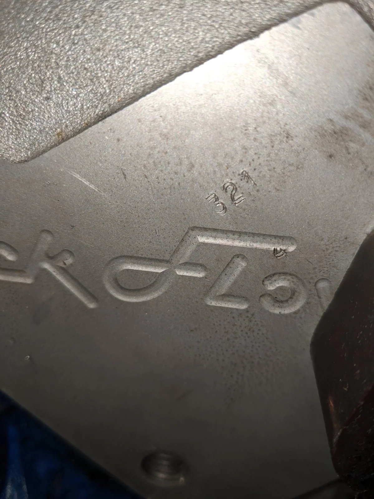

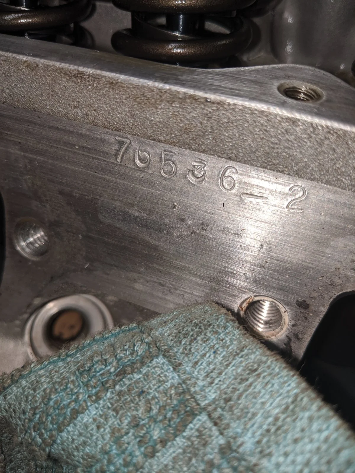

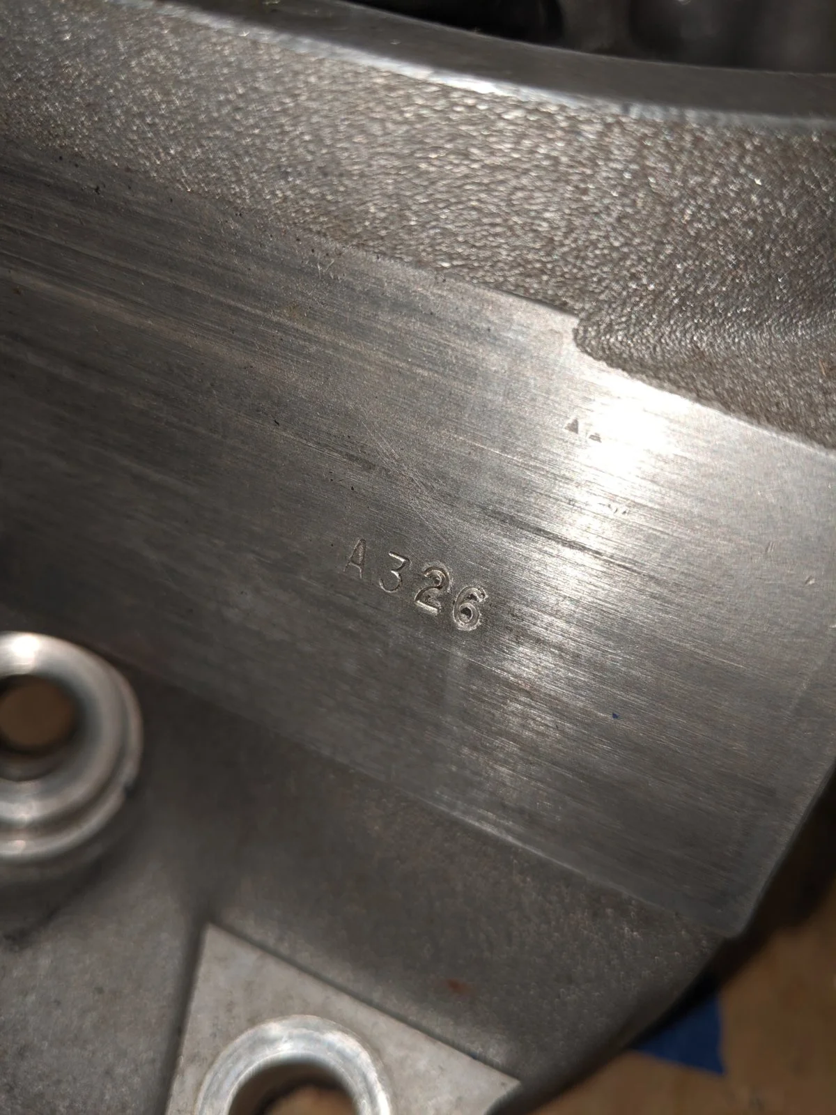

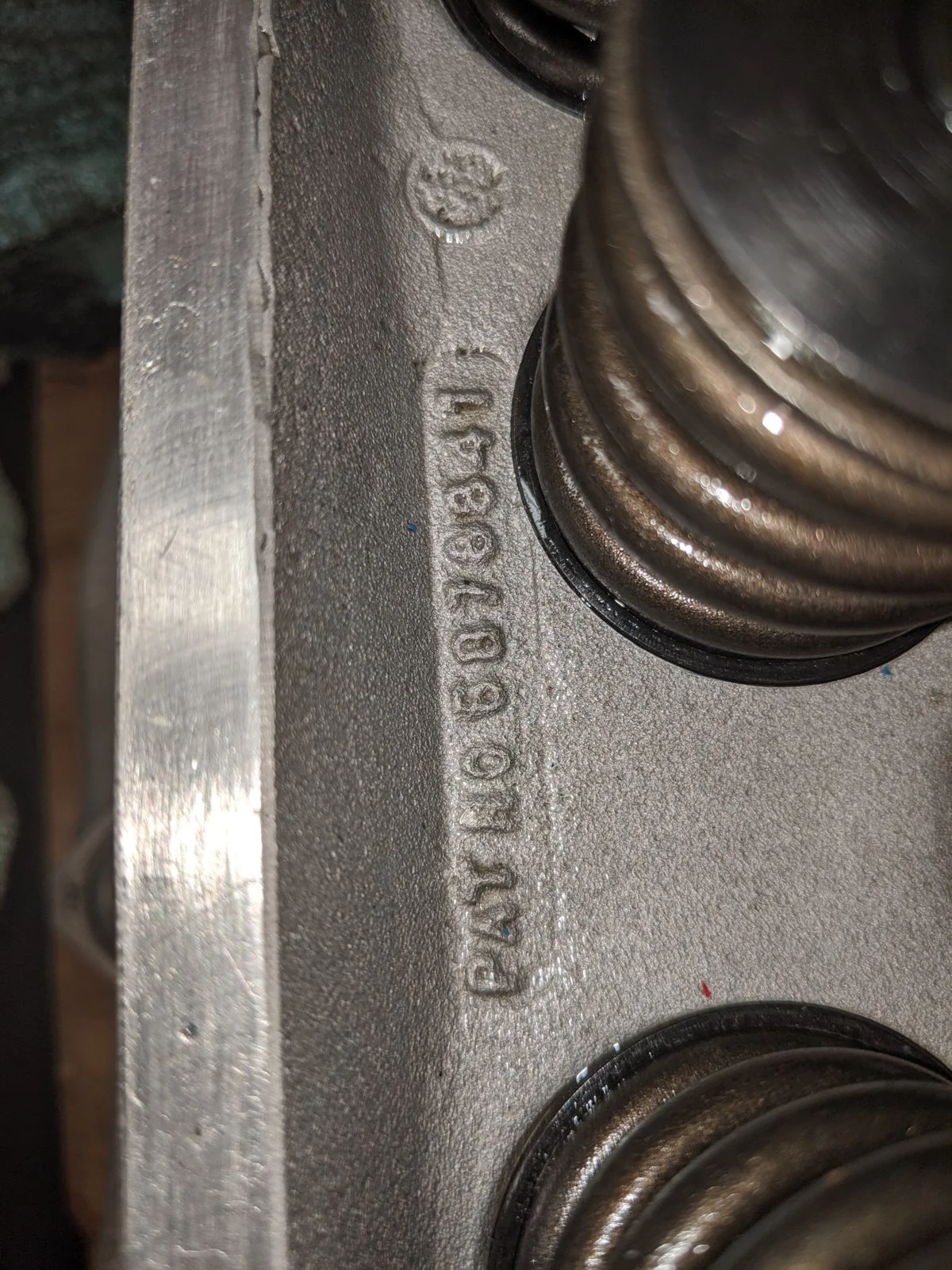

I tried looking with all these numbers stamped on the but I can't find which heads they are. There's isn't a cc stamp on them anywhere.
Just call trick flow as mike says.
They will know exactly what they are.
I have called them on multiple occasions.
Apparently they keep really good records.
