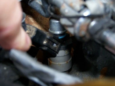

I bought a used 91 302, with 70,000 miles, put it in my 88 gt, did the mass-air upgrade, it runs good, just stock pretty much, getting ready to hot rod it a bit.
on my injectors it has # 3533 on them, they are silver on the bottom, black on the top, and a blue ring, around them right above the plug-in on the injector, I thought all stock were 19 lbs ( could'nt see ford on them, they are installed on the running eng, kinda hard to see ):shrug:

I did find a couple more #'s, they seem to differ from inj. to inj. one is "01D0628B , and another is, 01570BA. but I saw no name brand on them, I'll just figure 19's, because it's totally stock. the blue ring around it threw me off a little

ok I think I've got it figured out. here is a pic, LOL, I hope to show you all the injector in question, Thanxs Rick :flag: :flag:
They are Delphi injectors. The actual number is D1570BA. You had a ZERO in place of the D.
Info on the injector is here...
: Powertech Performance : INJECTORS D20LB
BTW, I use Corvette 25 pounders in my car. As long as they're high impedence you can use them.
