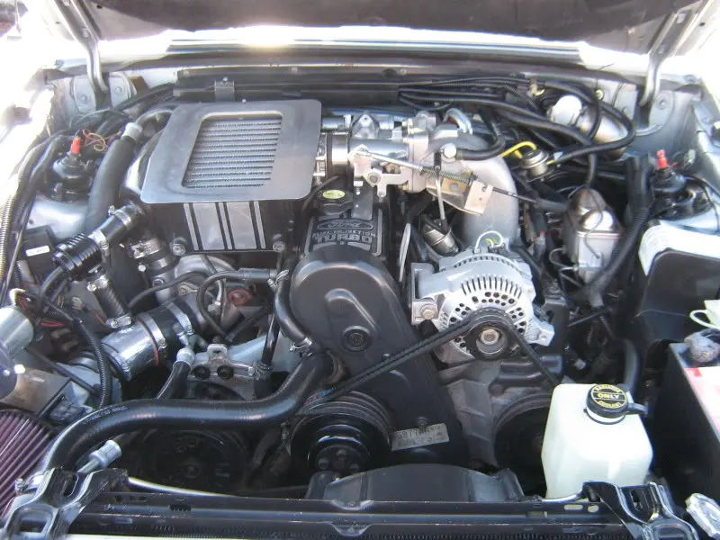

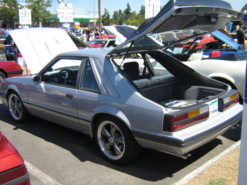

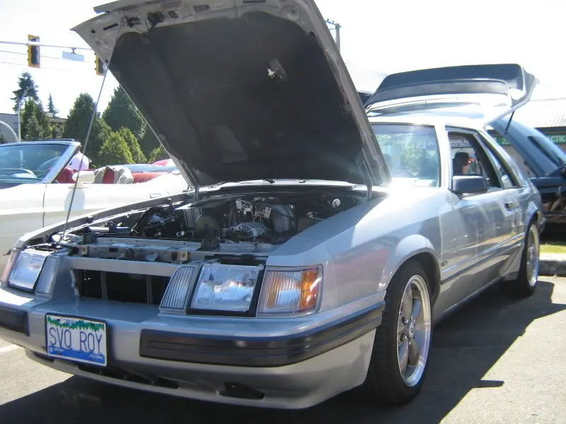

Swapped Mustangs are hard to find, Turbo Coupes are a little easier to find but unfortunately nowadays they are anywhere from 25-30 years old which means they may not be in the best shape.
I used to get 26 mpg highway in my '87 Turbo Coupe, and around 20 in mostly city driving.
they are getting harder to find all the time. Yes they were 200 HP stock. Mine was dyno'ed at 342
