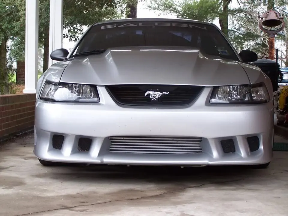

But it looks like I'll just supercharge my motor. I'm hoping ATI Prochargers are reliable (I like Prochargers because they come with a sweet looking intercooler).
I know you can put an intercooler on any supercharger, but the one thing I love about Procharger kits are that it's standard (comes with every kit) :) I don't like how Vortech sells a non-intercooled kit. I also want something to show in the "mouth" of my Saleen front bumper :)

If I had a penis, that'd give me woody! :D
