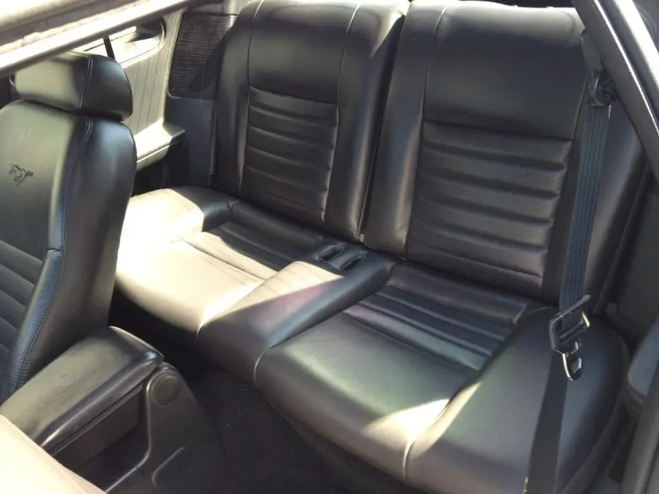

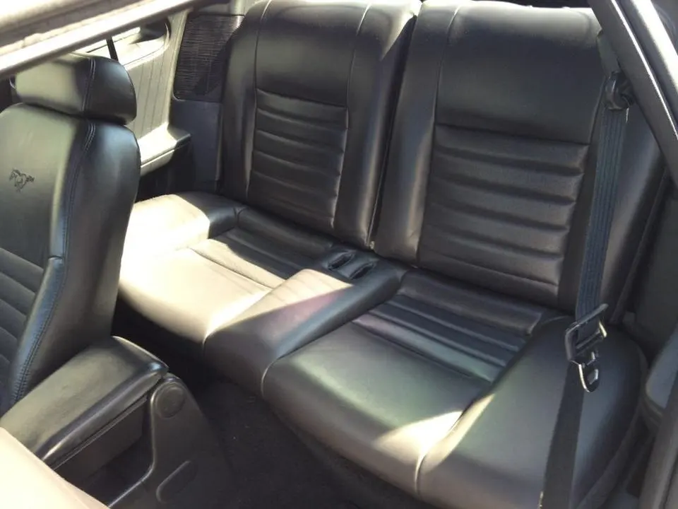

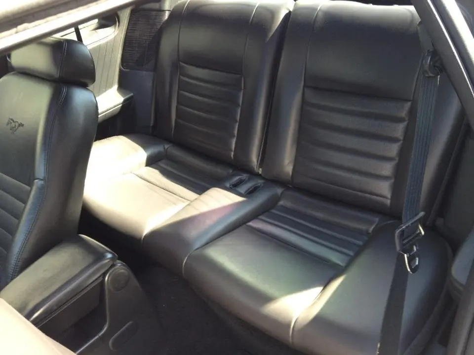

What i did for the back seat in my hatchback. Don't know if the convertible SN seat will work though. You could always have the rears recovered to match the fronts
Wow! Those seats look awsome in that hatchback. I'll bet most of the interior spacing is the same for the newer models. Looks like those seats were made for that Foxbody. Did they bolt in without too many mods?

No. They aren't a direct bolt in.
Seat bottom needs a custom frame made to secure it. Guys have used plywood for this, or cut and welded the rear parts of an SN95 into the fox. Since nobody sits in my rear seat..it's just laying in place. However if you sat in it and braked hard, the seat would slide forward. Not an issue for me because my car is really a 2-seater only. I won't put anyone out back.
Seat backs were easy. Basically you just peel the seat meteral off the Sn95 frames and transfer them to the fox body mustang seat frames. After that they just bolt right in. So basically you'd need a donar set of seat frames.
