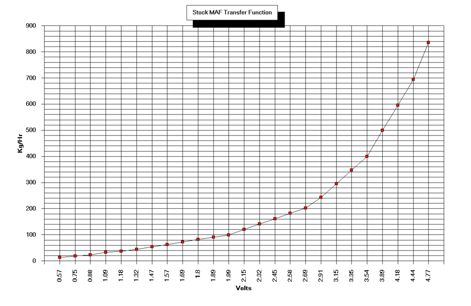

The MAF uses a 30 point transfer curve stored in the EEC. Each point has a voltage reference, and a KG/HR for air flow. Modifying the MAF will throw off these references at different points, and the EEC will no longer correctly calculate the a/f ratio. The stocker will flow fine up to around 400hp. So it is best not to mess with it. You are only asking for problems if you do.
