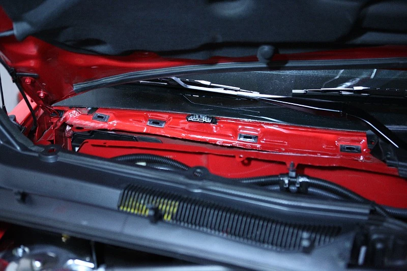

i think not all of the tabs were inserted correctly into the base of the cowl @ windshield. photo courtesy of DiMora.

I figured it out
I was having trouble removing the cover completely, it seemed to hang up behind the hood hinge. I finally just muscled that corner out to discover that my car has 5 tabs, the fifth one at the hinge side was the problem. It appears someone had previously changed the filter and twisted this tab. I straightened it out and reinforced it with a little glue. When I reinstalled it, everything seated properly. Thanks for the help fellows!
