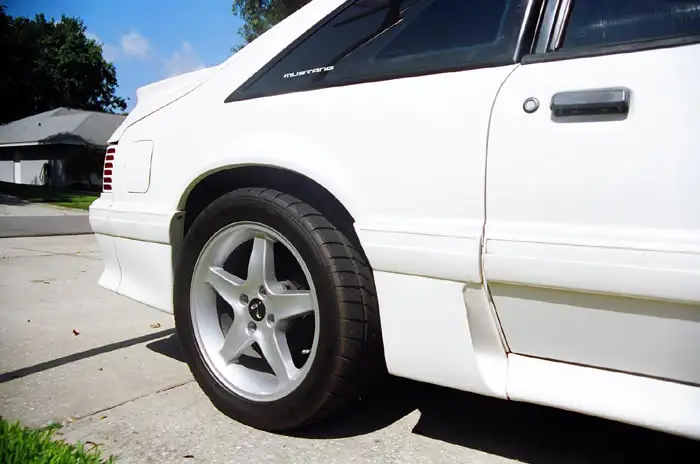

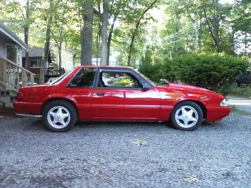

Its AMAZING, for 16 bucks, it does a great job, I need to use it on my car again BAD.
heres a very old picture, the day after clay bar, you can see in the vents and the edge, I always have rubber and dirt there that never came off, claybar did wonders for it, works gret on scuff marks, dirt, etc.
This is factory paint, the lighting is bad to see it shine, but its clean!

A claybar is the least abrasive thing you can use on a car. It will work wonders if the stuff is on the surface. A claybar will give your car a way better look and feel compared to a regular wash.
After you clay make sure you use a wax after it to seal the paint.
If you have deep swirl marks etc and the paint is not too great, I would clay bar the car then buff it all out with some compund, then seal it with a wax.
