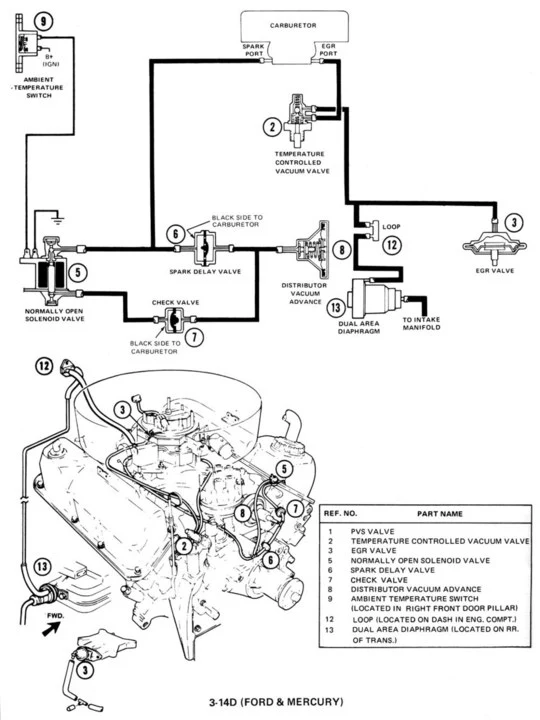

I think I'll just forget about trying to do this right for 73 and aim for something that works. I can't substitute the diagram 2+2GT posted as it has a dual diaphragm vacuum advance and I have single. (though I suppose I could change that . . . maybe).
The only diagram I can find for 351C that doesn't have solenoid valves, check valves and spark delay valves is this one for 1970:
Since I assume 1970 351C doesn't have an EGR Valve, I figure I'll plumb just the EGR to this diagram:
Also, (somehow I feel the need to confirm what's already been stated) a PVS (Ported Vacuum Switch) is the exact same thing as a DVCV (Distributor Vacuum Control Valve), correct?

FWIW, according to the correct 73 diagram (previously posted) the "Ambient Temperature Switch" is supposedly located in the right front door pillar. The one previously discussed in the air cleaner must be some other temperature sensing device.
Easily. But there were both variations every year.
Yep. Depends who. Ford calls it the DVCV. Usually.
On the front of it, visible only then the fender is removed.
Yup.

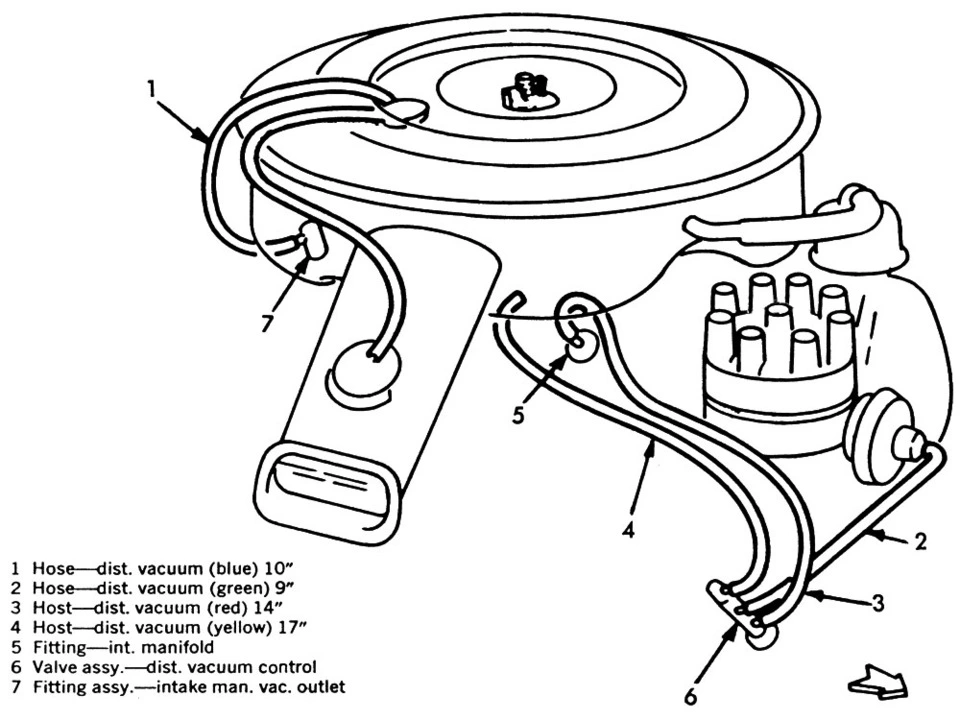

I have purchased a new EGR valve, but not installed it yet, and no emissions requirements for cars of this age. I was actually thinking of returning the EGR valve anyway as it annoys me that the hose connection is pointing up and to the left rather than the correct down and to the right position.
Well that looks remarkably similar to this (picture below), which I desperately want to get rid of as it sits awkwardly on top of the alternator (currently removed).
Yes, please. If you have a convenient hose routing diagram I would very much appreciate it. It's amazing how limited the shop manual is for this kind of info.
