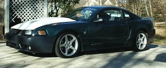

Well she wants to buy a set of 18inch saleen rims, and lower it. Shes really into the lowered look.. I dont care much for it on my car since i need the weigh transfer. But i think her car will look great once its all said and done. I have talked to a few people with "C" springs which are very happy with them so i think that may be the route i go. I think a 1-1/2 inch drop with 18" rims will look good. You guys agree?

That'll look pretty sweet. :nice: 18's are pretty huge though.
yeah, make sure she's sure about the 18's. i ordered 17's and they sent 18's, so i was psyched a first, but they were WAY to big on my car, so i had them send me the 17's. I think they look pretty good, check out my link below.
