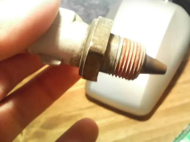

what sensor is this? PIC asap

what is this too...jacked my stang up and it was sitting behide the passenger side wheel...where dose it go? :shrug:
coolant system sensor for the computer, Not the TEMP gauge though. the one that goes into the coolant tubes towards the heater core and all.

EFI cars need that sensor, mandatory.
As others have said that is the ECT Sensor (Engine Coolant Temp). It goes in the hard heater lines where they come off the passenger side front corner of the intake manifold. Will your car run without it? yes but it will run rich. When I got my 88 it was missing the ECT because the yahoo who owned it before pulled the hard lines off the car when the heater core went bad and just plugged the threaded hole in the intake.

Uh no!! I tells the computer to richen and lean the mix when it warms up. my 86 dosent have one and it runs awesome!! so mandatory I think not. its all in how you tune it!

If you have one installed in the heater tube more than likely it was changed out at some point, set on the inner fender and forgotten about. Then over time it worked its way down to where you found it. Happens with my wrenches all the time :rlaugh:
