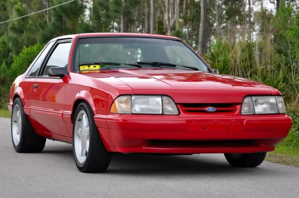

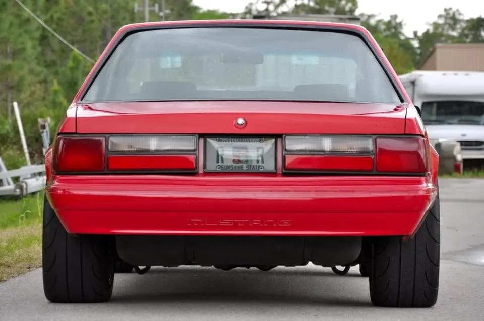

I've got 255/40/17 in the front and 275/40/17's in the rear on my Coupe with 17x9/17x10's on it.
The front fits just about square on the 9" wheels and I get the slightest rubbing when cornering hard, or bouncing into a driveway. 245's are just a hair too narrow on a 9"wheel IMO.
If I had the choice though, I'd go with the 285's in the rear. The 275's don't offer much in the line of "curb rash" protection, if you know what I mean. The choices are kind of limited for the 10" wheel. A set of more common 315's are too wide for the rim, but anything in between screws up the aspect ratio of the wheel/tire combination.
275/40-17 M/T DRs on 17x10 Pony Rs. The car hooked like crazy (with good suspension) on those tires.
A 285/40-17 would fill out the wheel a little better, but I wouldn't say that the 555rs would hook any better than the M/Ts.
I've seen 315/35s on 17x10s, but they are a little wide for that rim.
