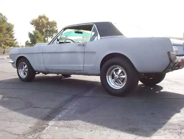

out back arre 15X8
front are 15X7
Im going to go with 15X4's out front pretty soon
I personally dont really like the big wheel loog on mustangs.. I have seen a few of them done well Most are here on stang net.. I like the site of big meats under the fender wells
