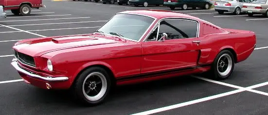

Here's my car with:
American Racing Torq-Thrust D's, 15" X 7" w/ 3.75" backspacing
225/50/15's on all four corners

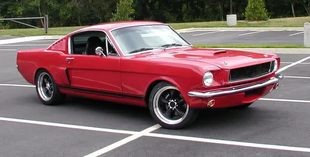

and here it is with:
American Racing CL-205's, 17" X 8" w/ 4.75" backspacing
225/45/17 in the front
245/45/17 in the rear (I could have fit 255/45/17)
