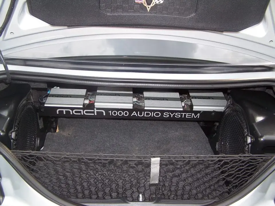

Wanting to replace the speakers with some kickers thinking the KS Series or RS Series from them but I don’t know what size the front and rear speakers are, I have the Mach (460 I think) in the car now.
Edit: forgot to add i have a 1997 GT
Thanks!
Yea I was debating on this a few months ago. Turns out it can be a little questionable. Regardless of the speaker size you end up with, sorry not sure what it is aftermarket speaker sizes are. Problem is stock speakers are 2 ohms and aftermarket are 4 ohms.. I think the 460 system was designed this way for the added bass for midrange speakers. I read aftermarket speakers do not sound as good with the stock amps. Take my reply with a grain of salt however because I am no stereo guru.

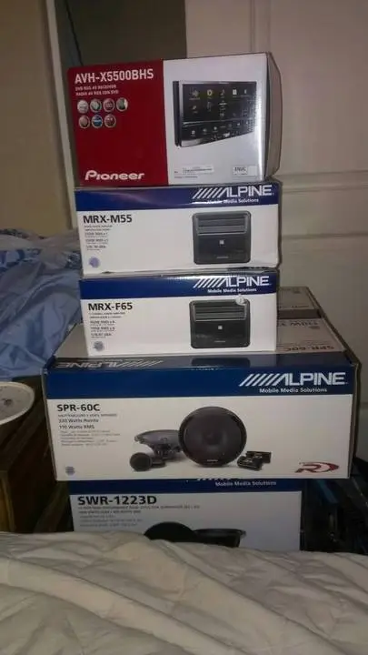

I went this route...
There's 2 twelves in that pile. I've heard alot of talk about compatibility. Didn't feel like dealing with it. It rattles your teeth pretty good. :D
Sent from my EVO using Tapatalk 2
Reactions: Deek

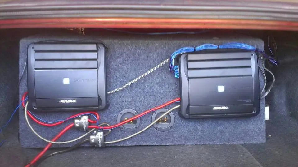

The M55 is a mono sub amp running the twelves at 350 rms at 2 ohms.
The F65 is 4x100rms running the tweet/6's

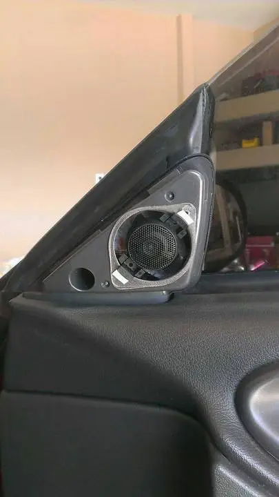

The SPR-60C is a component system with a 6" woofer and separate 1" tweeter. Mounted the tweets in the factory location. One of the mounts they include slides right in.
I didn't use anything from the factory system. It's in a pile collecting dust.
Reactions: Deek

That looks like a good fit setup! So basically you power everything except the subs with the mrx-f65, the spr-60c include the doors, back, tweets and crossover for tweets, and you power the subs with the mrx-m55. Did you locate the front amp at the same spot as the original factory? I'm just trying to figure out how it all works cause that looks like a great combo.
I thought the factory amps where in the trunk under the rear speakers or is that just my year?

I have 2 in the back under the deck. I also have one behind the radio sitting on the hump. I found it while I was swapping my whole 2000 center console and radio bezel for one out of a 2003 SVT. I wanted the 2 din slot, and I was tired of hitting stuff in my front cup holder every time I went in second. Also, moved trac control and fog under the radio.
Each system has 2 tweets/2 6"s. One system in the doors and one in the deck.
For all I know there may be an amp in the front, but I wasn't paying real close attention. That Pioneer slid right in. Had it hit on something, I would've paid more attention. I've heard that third amp mentioned, but wasn't really thinking about. I was sick as dog when I was installing all that.

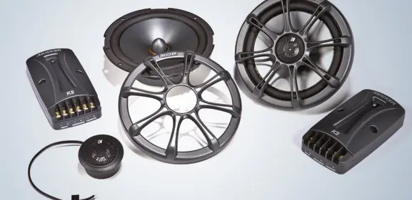

Thoes SPR-60C are 6.5" speakers right? and the car has 6 x 8, did the alpines just screw in fine no drilling/brackets?
If that is so then i think ill go with these, Kicker KS65
One of the main reasons I have kept my 97GT long as I have is because of the sound system. My recommendation is to completely eliminate the mach 460 amp and wiring. The amp isn't very clear, not a good match for aftermarket speakers and really buried in with the wiring.
