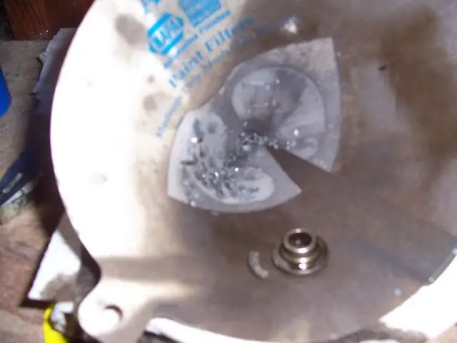

well got the engine out and torn down slightly. (due to making a heck of a knocking sound)
so anyway when I removed the oil pan I found a few things... lots of metal shavings (which I didn't find when I drained the oil while the motor was in the car btw), and about half of a washer looking thing. what is there is also a little cracked. whatever it is is in bad shape and most likely cause the problem.
took apart some of the head (the valve train from the cylinder that got the bad compression before) and there is nothing there that even resembles this piece I found in the oil pan. closest thing to it is the outer edge of the valve spring retainer, but it doesn't match up perfect. I sat a retainer next to the chunk I found in the oil pan to give you an idea in the picture.
anyone know what this could be?
now the other question is, do I scrap this motor and just find another one or keep going? I really wasn't planning on pulling the crankshaft and rebuilding everything is going to cost more than just buying a new motor. I really though the problem would be in the heads but they look fine so far.

i cant really make out what that is from the pic, but it seems like you may have been sabataged. any enemies that could catch you with your hood up?

the shaving's are likely bearing babbit,the half moon piece,no idea.kinda looks like the oil pan drain plug sealing washer

sounds like a spun rod bearing to me

same here
I was thinking washer or retainer or something like that too, till I looked close. should have mentioned the inside portion of that is recessed.
anyway if it is a spun bearing, then chances are the crankshaft is cooked as well, so if I change that I'm looking at all new rod bearings right? any ideas what this is going to run $wise?
I'm thinking about just buying a transplant

if the rods aren't damaged you'll be looking at about 800 doing all the work yourself.
thats if the crank is to far gone to be resurfaced.
you'r better off just paying the extra and getting it forged.

anyway final verdict is 2 bad rod bearings, #4 and #8. crank looks ok to me but I guess I'll be taking it somewhere to have it checked out.

make sure you put a new oil pump in as that part looks like part of the pressure relief valve in an oil pump

thanks for the tip on the oil pump, didn't think of that but it makes sense, that piece was in the very front of the oil pan

took apart the oil pump completely and everything looks fine, may still look into a new one though
