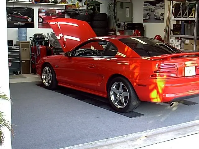

So I found some 17's being sold in my town. They are '03 SVT cobra rims with 5 lugs, will these fit my '94 GT? I know it has 5 lugs as well but I just want to make sure they are the same size. Thanks in advance!
I have a hard on for the 95' Cobra wheels, not the 03' ones so much. It's all personal preference. there are some great deals on OEWheels, but they are Chinese knock offs. I personally don't trust a wheel made in China.
