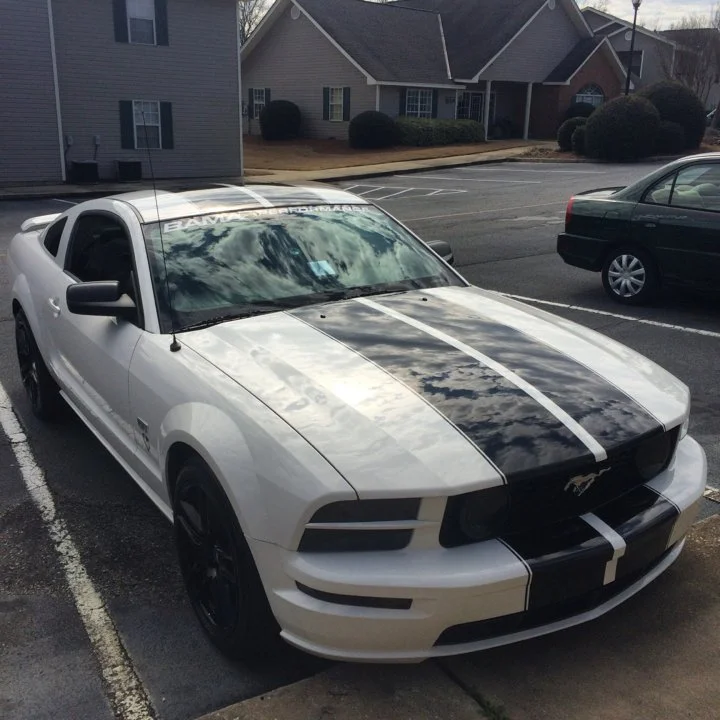

looking at what to do next to my 2006 Mustang GT so far I have
AIRAID CAI
BAMA tuning
catless H pipe
3.73 gears
underdrive pully
19x9 front wheels 19x10 rear wheels
American thunder axle backs
Eibach full pro system kit
Stallion upper/lower control arms with relocation mounts
GT500 front lower control arms
I'm considering getting
FRP throttle body and intake manifold
MAC long tube headers and a MAC pro chamber
Are MAC exhaust components worth the money? What's a good axle back to go with that? I like my American thunders but I want something more low and mean but no drone at highway speed >.<
Also thinking about getting cams and either supercharging or buying a hellion turbo kit. If supercharging I was thinking more along the lines of a vortech or pro charger. Any suggestions? Thanks guys!
Unless you're going to turbo it I'm not sure the FRPP manifold is a good choice, it requires a lot of RPM to make power. I'd save that money and add it to the long tube money and get a real set of American Racing Header long tubes. If you're going to break knuckles installing long tubes might as well get the most power and highest quality. You could also get the STEEDA CMRC delete plates to get more air in. Upgrade TB is good idea, I went to a GT-500 unit which did make a difference i did feel.
