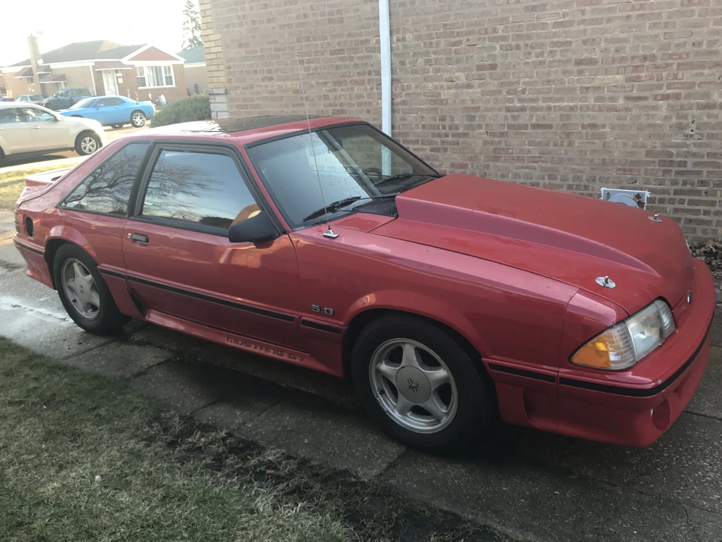

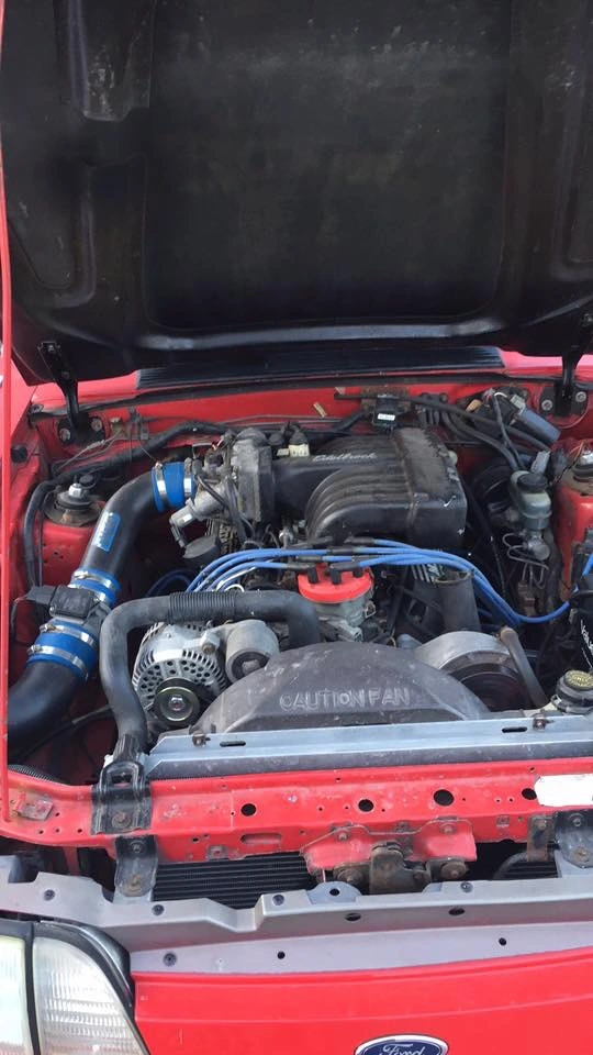

so about a month ago I bought a 1989 mustang gt. I'm looking into putting some more mods on it and not sure what to do since I'm new to mustangs. The car has shorty headers, o/r h pipe with slp loudmouth cat back system, cold air intake, upper and lower edelbrock upper and lower, ford stage 3 racing clutch, mishimoto radiator, ac and smog delete. This is what I was told was done to the car since I'm new to the car not exactly sure what to do next. Looking to get some pointers. Thanks everyone

Post a few more pictures of your mustang for us to see.

Well didn't expect to get this many answers. Now I definitely need sub frame connectors I know that gonna do that within the next week. I'm trying to go for a fun summer car that has good power and turns heads. The car needs paint but I'm not to worried about that right now. Also forgot to mention I have 3.73 gears the guy before me said it was dyno tuned but he didn't provide any sheet so I would never know.
